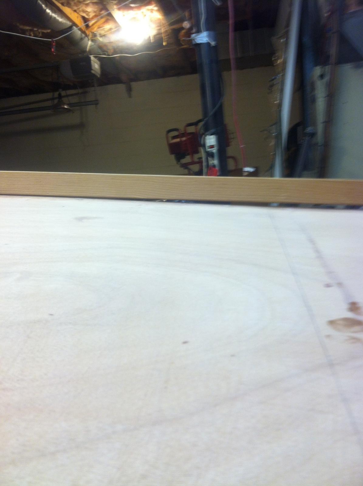

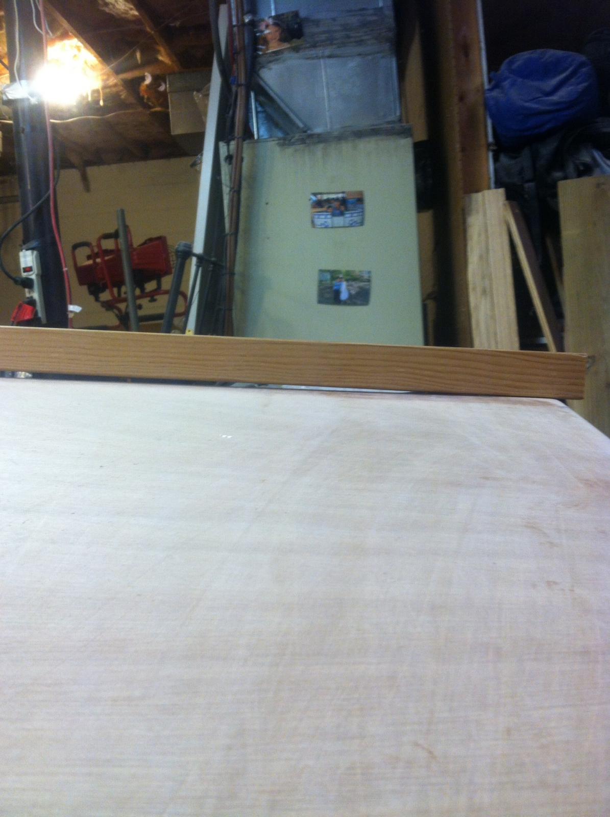

Thank you all for the suggestions on the seams.....was not as difficult as I was making it in my head. Now I have a new head scratcher... There appears to be a dip maybe 20 inches in length...approximately 1/2 inch at its greatest on the centerline just before the transom. Attached are some pictures. Any idea what caused this? Do I need to fix it and if so, How? Couldnt get pictures to load....will try again tomorrow. Thank you for any help! Will

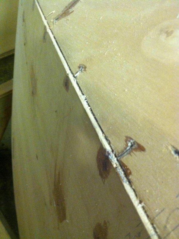

Here are some pictures... The first two are of the area where the side panel is not aligned with the bottom panel. Others = before the flip
I have flipped the boat and would appreciate any help with several questions: 1) What is the best way to radius the plywood edges along the chine to ensure consistent lines? 2) How much does it need to be rounded....how much material needs to be removed? 3) There are several places where the side and bottom panels do not meet perfectly. How do I address this where the side panel is proud. Do I sand the side panel ...apply fairing compound/goo to the bottom panel? (Tried to download pictures but could not ...will attempt again later) 4) I will glass the hull with 6oz glass. Do I also need to put 2 layers of 10oz tape on all seams? Thank you, Will
