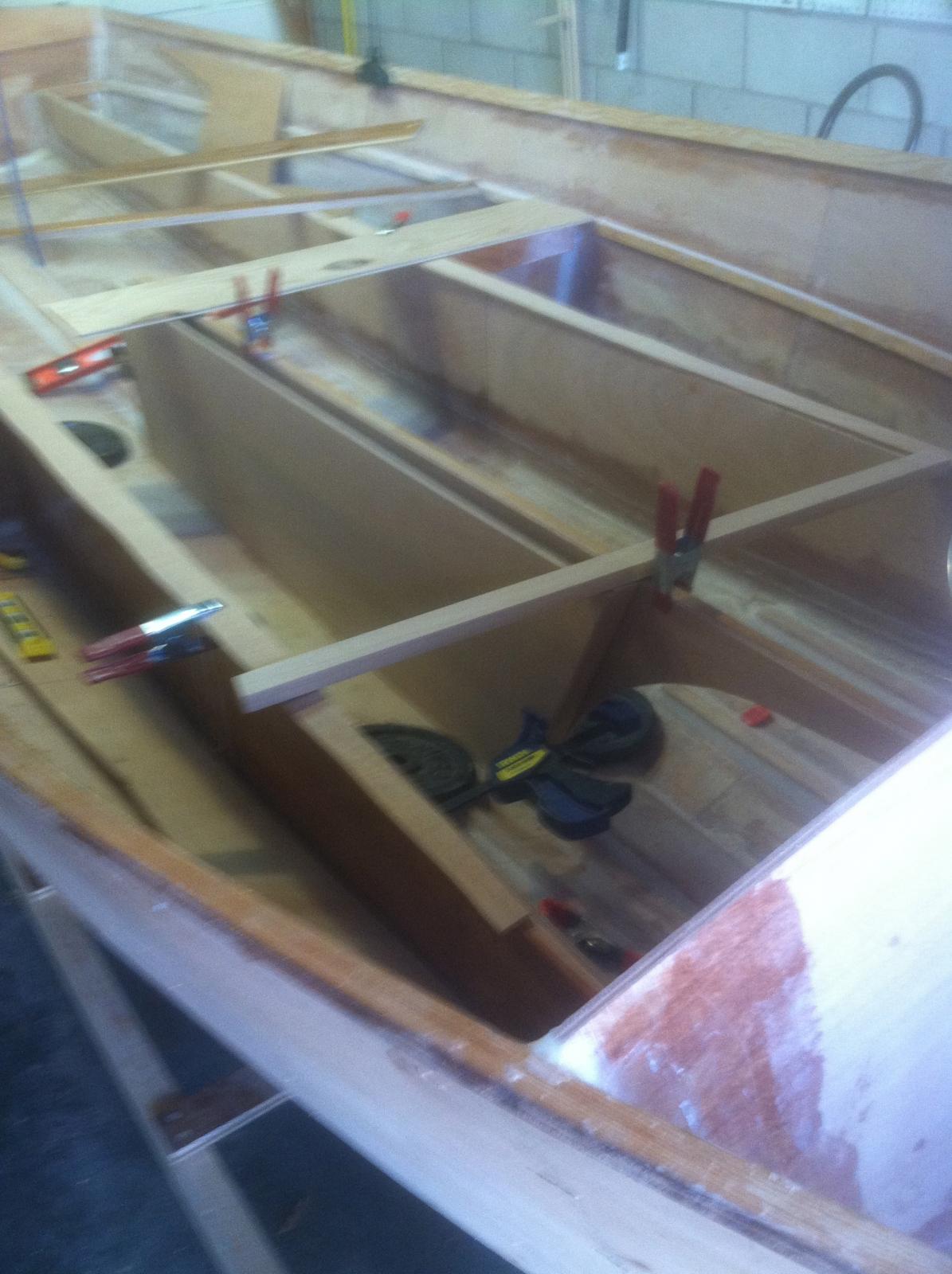

I have installed the framing for the hatch and will put in the king plank next: Do the transverse members and king plank need to follow the arc of the forward bulkead and deck beam? It appears that the deck would be very flat otherwise. Thanks for any help, Will

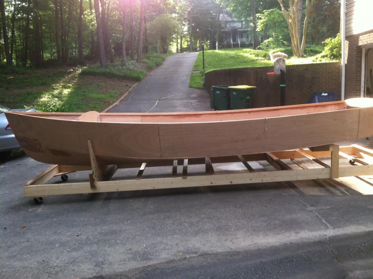

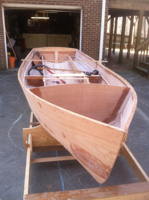

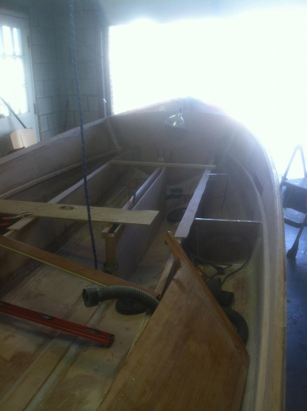

Centerboard case has been a challenge. Have it in place but have several questions; 1. used 3/8 ply (do over and did not have more 1/4 ply)....is this a problem 2. top of case on 1 side is about 1/8 inch below seat tops...is this a problem 3. having hard time visualizing the cap....where does it go.....does it add height to the case? 4. did not mark pivot hole location before fitting the sides....how to find the correct placement for the pivot hole? 5. Should I just start over....and if so would someone share the most efficient way to go about it? Attached are a few pictures of the build and 2 of the case as it is now. Appreciate any help. Thank you. Will

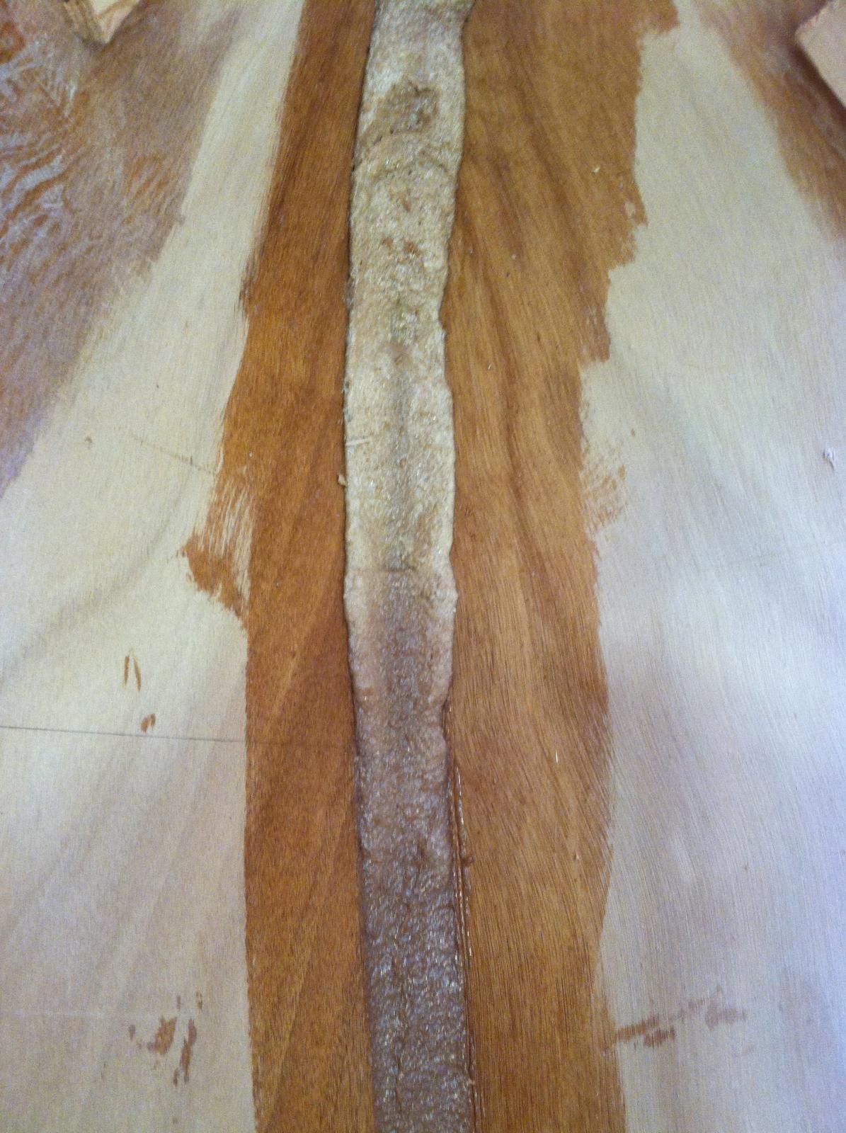

I will say that the 5:1 resin is much thicker making the use of a pump impossible. The measuring was difficult....at least the way I did it....as I first poured a pre measured amount into a cup X 5 and then 1pour of hardner. Getting the thick goo out of the cup each time was difficult and it made exact measurement very difficult. I would like to hear people's opinion about any benefit as far as strength/rigidity goes. This Resin/Hardner was advertised as being particularly strong and excellent for structural bonds etc., etc. Anyway, I am planning to go over current fillets with 2:1, as it goes on and cures much smoother in my experience. Thanks for advice on cooked epoxy....it is definitely cured and was almost immediately after it started to go off. Will grind it down and cover.......cant imagine being able to get it out of the bow without destroying the boat. Unless there is a clear reason to remove the wires, i plan to encapsulate them and forget it. Thanks again, Will -

Thank you for the suggestions. The wires are steel. The epoxy is from RAKA.....I used the 5:1 thinking that it would be stronger/stiffer. It worked great on all other areas of the boat....guess it was to quantity of the epoxy in that one place that caused it to cook. I will attempt to determine twist and hope for the best. Thanks again, Will -

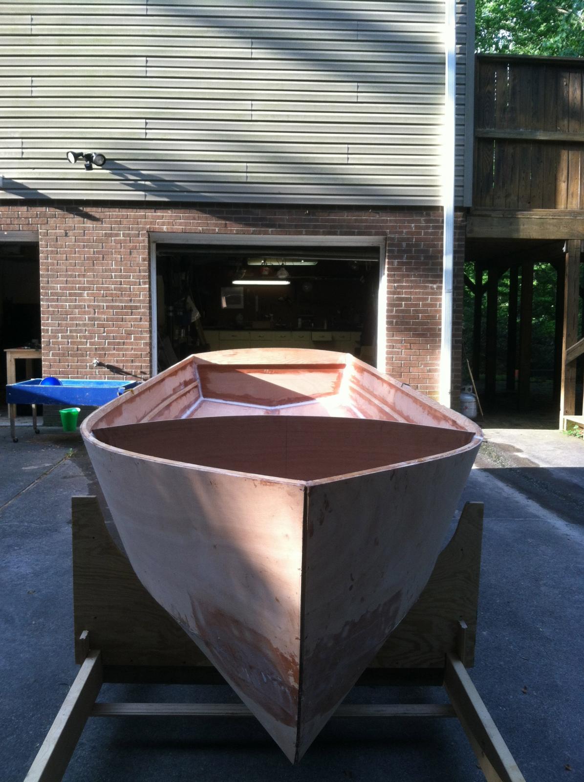

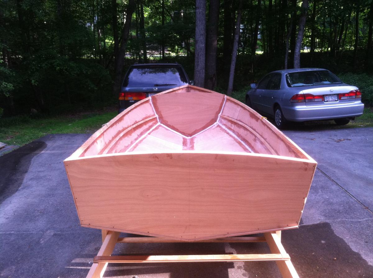

Hello everyone, So far boat has seemed to come together pretty easy.....maybe a little too easy... Questions: 1) I let the epoxy cure fully before removing wires.....epoxy is 5:1 ratio....all but approximately 8 wires were removed with soldering gun and meditation. The 8 remaining wires are through the front bulkhead/hull and refuse to budge.....I nipped them off at the surface. Can I leave these wires in? Please say yes. 2) I am concerned about 'twist' as I did not level, plumb bob, or anything else I probably was supposed to do when putting in the front bulkhead/temporary support. How do I test for this and is it correctable at this point? Are you able to tell anything from the attached pictures? 3) The epoxy over approximately 12-15 inches of the centerline seam in the bow apparently kicked off/overreacted....generally behaved badly and resulted in a bubbling up with apparent porous consistency. Do I need to remove this section and if so....how? Picture of delinquent epoxy below. Thank you very much for any suggestions. Will
