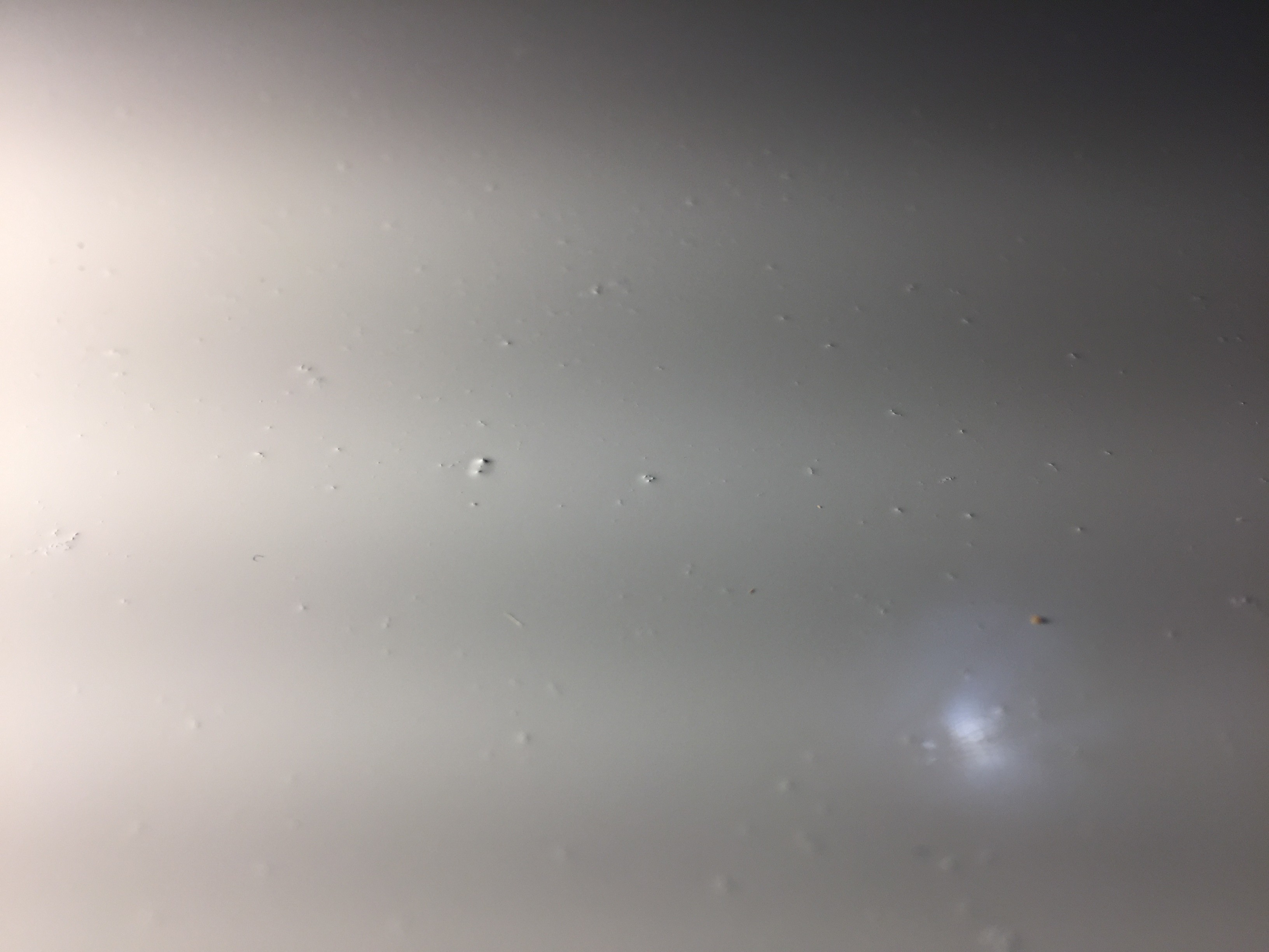

Thanks par... you were right...much more dust than I thought despite the plastic tent....painted outside in nearly ideal conditions with much less of a problem. Some pics attached
Primer was in place for several months....no air supply... in and out via a slit in the side( painted with supplied air)...of note.. initial topcoat done without the booth with same result... tipping brush = red tree 2" badger or Wooster yachtsman(didn't seem to matter) bumps are size size /consistency of dust specks but appear immediately after tipping. See attached picture....
Any advice greatly appreciated: painting awlgrip topcoat and keep getting bumps in the finish. Have minimized dust(boat is totally enclosed in plastic suspended from garage ceiling), varied reducer from 15-30%, used various rollers, cleaned tipping brushes, strained the paint, wiped surface with recommended solvents, tacked the surface, ....all to no avail. the bumps appear to be paint solids when I sand them out... awlgrip rep suggested painting outside. any other suggestions?
