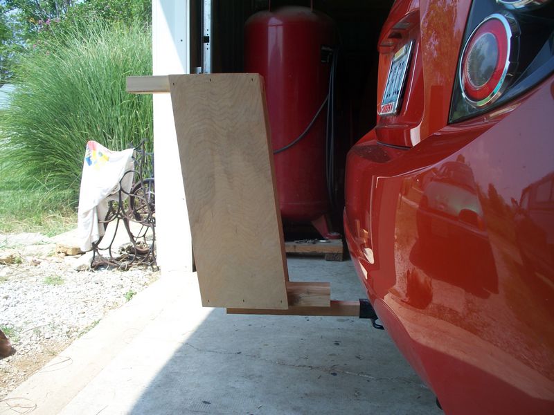

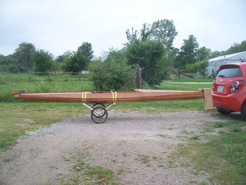

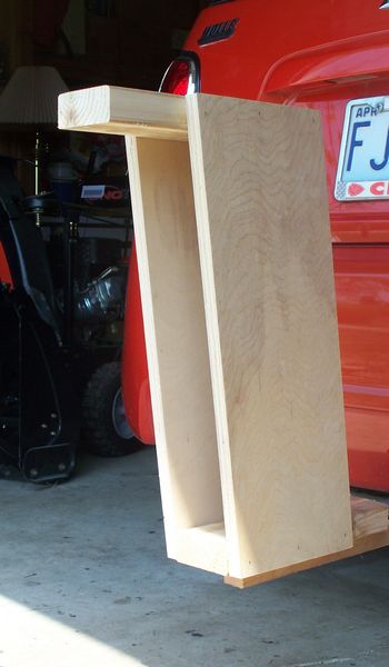

  7. I cut a piece of 11/4 oak to slip in the receiver and stood on it, no problem... This would allow the nose of the boat to fit between the ply., hang a Carabiner from the 2x4 to hook onto the grab handle.....
  8. Well, exactly like behind a bike...With less parts...when you pull it by hand.....I could go the route of making an arm extending off a receiver, to hang the bow from the grab handle....Just, someway limit the swing when being pulled.....

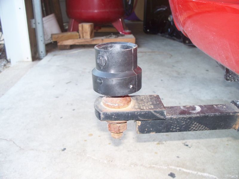

  9. So, with any camper with roof racks and pulled with a vehicle without racks. So, you get set up at a campground only the site is not near the water....And you have a pull cart with wheels, but you don't want to walk the park road up and down hills pulling the darn thing...How to adapt a piece that will fit over the ball hitch and bungee to the kayak? It will need to be secure to the kayak to keep it centered over the hitch ball.... I like things simple and lightweight.... For starters PVC fittings..... It needs to keep the nose of the kayak a distance from the back of the car... Some kind of material to create a V notch to line with foam and secure to the bow grab handle! That is the dilemma... A bungee can keep the thing secure with the ball... But securing it to a variety of kayak bows in my fleet....?
