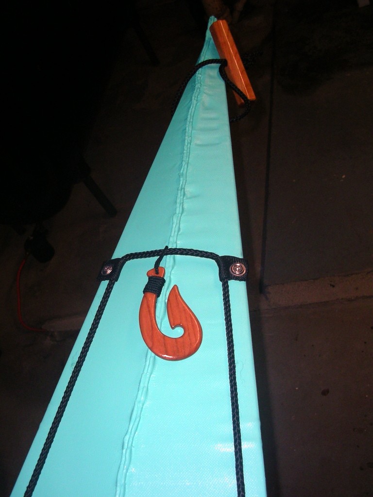

  9. Thanks all. That Maori fishhook is called a hei matau and is intended to signify strength, good fortune, and safe journeys, especially over water. Seems appropriate. I have done the same thing as an inlay with wood strip boats, but lashing it on just seems right for the Ravenswood.

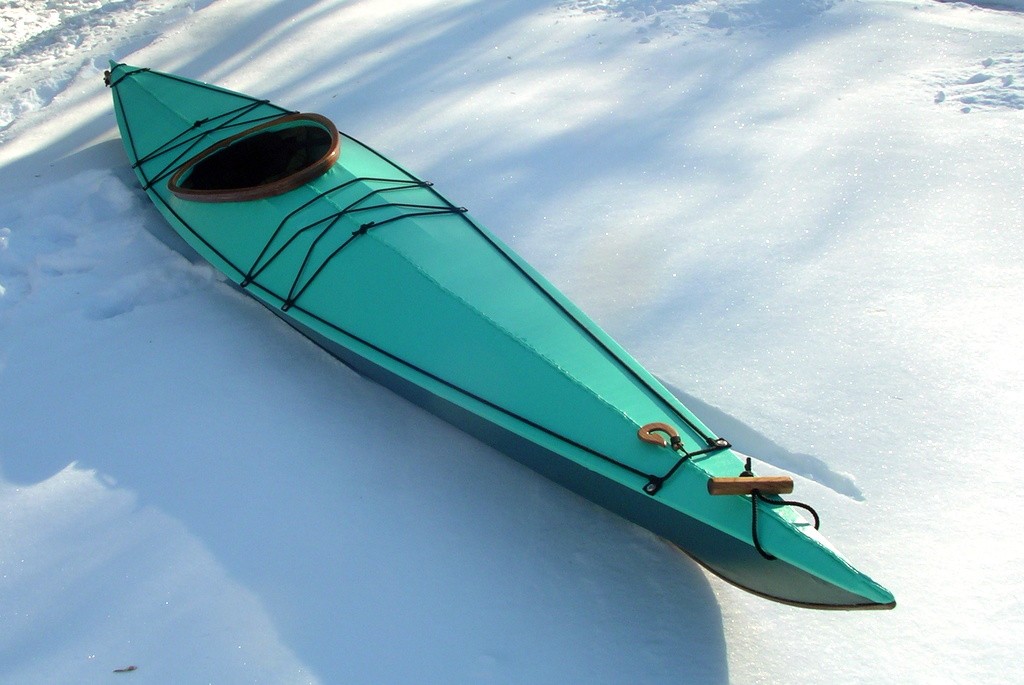

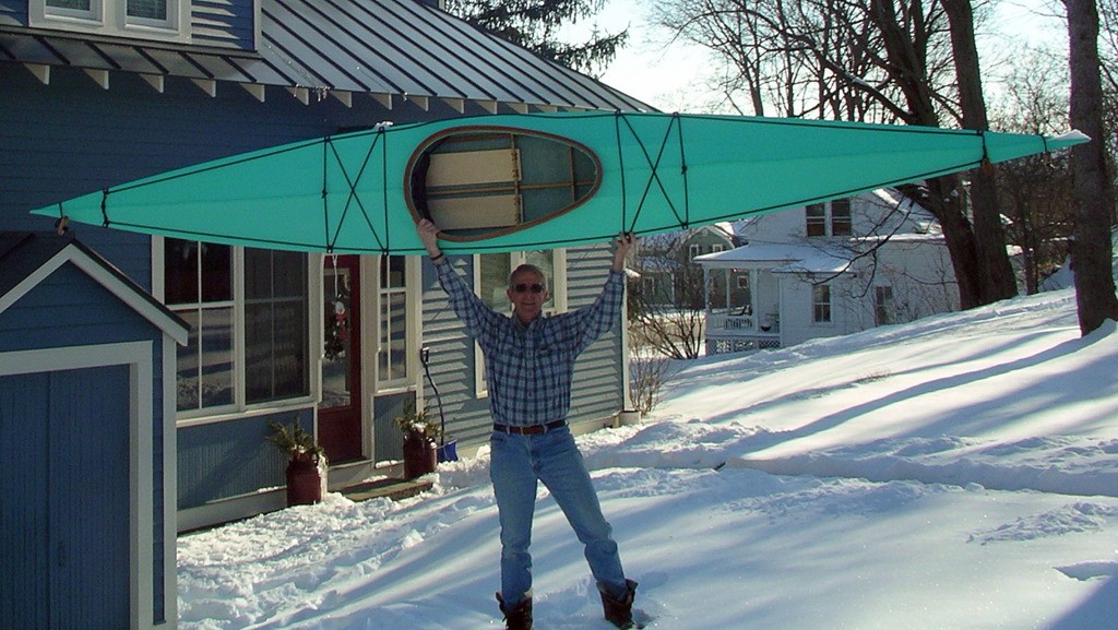

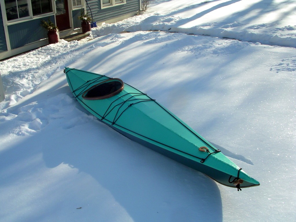

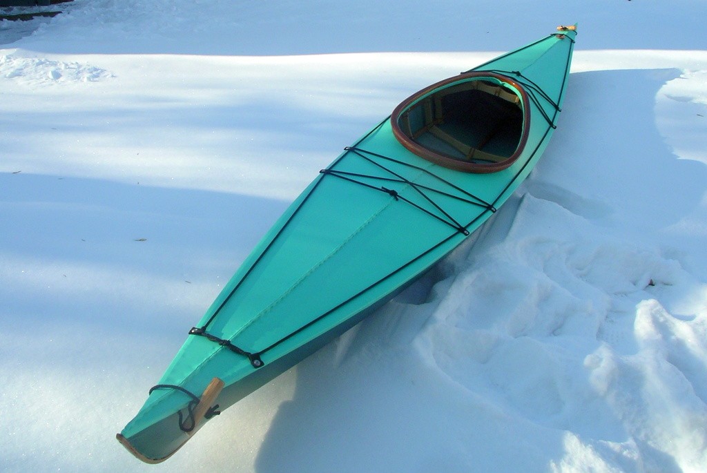

  11. Hi all, These winter project Ravenswoods seem to be popping up all over! It's going to be a while before sea trials up here in VT, so snow trials will have to do: Final weight (fully fitted out): 26.5 lbs From the construction log: Setup, initial wood work - 23 hrs Lashing, finishing frame - 29 hrs Skinning, painting, fitting out - 28 hrs Total exactly 80 hrs. I can't match Pickman's paint job, but every boat needs a personal touch, in my case a Maori influence: I am very pleased with the Ravenswood design and the whole construction process. This is my third SOF but first of Jeff's designs and I can't say enough about the difference a good design makes. Now I just need the ice to melt up here. Oh yeah, and for those new float bags to appear in the Kudzu store. Meanwhile, back to the cross country skis for a few months. Cheers, Steve

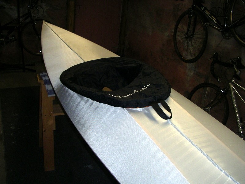

  15. I test fit my Wilderness Systems spray skirt on my Ravenswood (under construction) and it works great. Don't know if it is still available tho, it is an oldie but a goodie.
