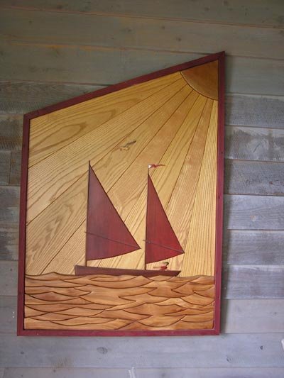

Mike, I think I have seen some of her work. Beautiful stuff. The one above is the only one I have made. The cedar is eastern incense and was from the knarly base of a very old tree which showed some wavy patterns. What I have not seen is any western cedar with the colors she was able to find. All the western red we see is mostly rather bland and none of the light color sapwood. Guess you have to be close to the source.
John, I did an intarsia picture a while back. You may have seen it on the west porch when you were here. It's made from ash, cherry, walnut, pine and carvings of man, pennant and bird are dogwood. Dogwood is the best local carving wood, even better than tupelo as it will not split easily and holds detail well. Sorry about the double photo. Novice geek at work.
That is the man. I took the photo without flash in fairly low light so he is kind of blurred. At night after a day of building, we both get kind of blurred anyway.
