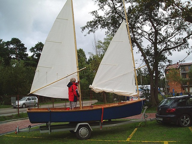

This summer I took BRS17 to Finland again to join the archipelago small open boats cruise called Raid Finland. There were all kinds of weather including a front from the west passing over us with a short squall which catched us underway. It took about 1/2 hour since we noticed small dark line on the horizont to be hit by strong blow and rain from big dark low cloud with a rugged edge. That /2 hour I decided to use full sails heading to the coming front to get away as far as possible from a lee rocky shore of the big island we were passing along. Wearing rain clothes , fixing gear etc. Few minutes before the big blow we fixed mizzen to keep the bow facing the wind, pulled down the main to reef it. Next... it was too late to try to reef the mizzen. We started to continue sailing having a schooner rig. It was really nice and efficient sailing, rewarding enough to ignore heavy rain. We have had good drive to be really safe from the lee shore. After another 1/2 hour the squall was over. No photos of that episode, but I have found old photo of Doppio being rigged for the first time , still on the trailer, I called it "parking cruise", and it was the schooner configuration tried unintentionally. It is attached, hopefully. You can see tha main/mizzen ratio . Well, what do you think about above story? About using a schooner rig in emergency (as I had no idea and even no intention to think how to reef the mizzen that time).
