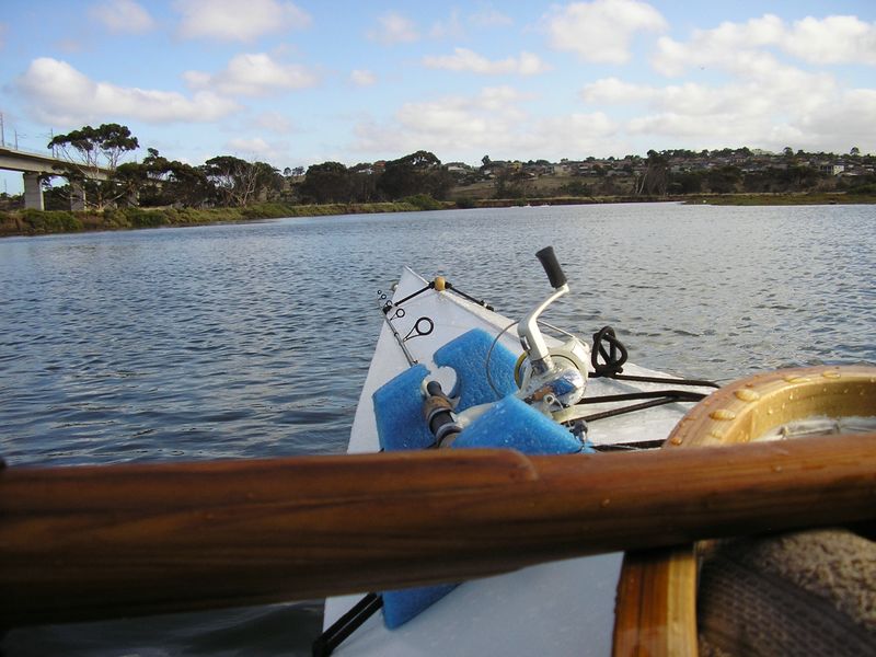

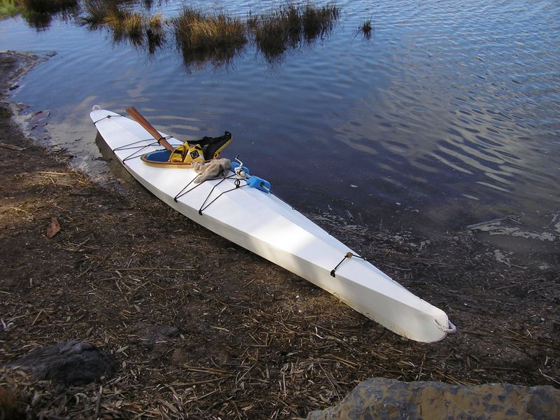

labrat Posted January 26, 2015 Posted January 26, 2015 The actual first launch of my Curlew was posted before this section was created so this trip report is to present the finished boat here as well as in the main forum.Some discussion about Greenland paddles on another forum prompted me to take my Curlew out on our local river to try my stick out again. Past attempts at using it were dismal failures, causing soreness that other people say a GP prevents and leaving me frustrated with the lack of progress for the effort put in.This trip started out in a similar way and having tried a number of strokes – high, low, short, long, different body rotations etc – without any appreciable improvement I then changed the grip. Previous advice was to grip the paddle so the blades are angled forward just a little and this is quite a natural way to hold it but I have always found the wing effect creates downward thrust this way and it is very destabilising.So the blades were rotated back to vertical and by using a medium low style stroke with some in to out side sweep (a bit like a wing paddle stroke) the paddle started to generate some power. I need to go out again soon and see if this works twice in a row but I think I have it nailed.On the way back there was a reach that ran directly into the wind which was whipping up little wavelets up to around 6 inches high with some losing the tops in the wind. Wind speed was around 15 knots and for the first time I could feel the hull really flexing and my feet being pushed up and down by the water action on the skin. Despite being very unfit at present it was not a struggle and I think for the speeds I do that Curlew is a nice easy paddling hull. It also has sufficient stability to cast from if you like fishing or for taking photos. I threw a soft plastic around for a while on this trip and also photographed a group of 40 - 50 pelicans lurking on the bank. Quote

Action Tiger Posted January 28, 2015 Posted January 28, 2015 It looks like a river near here I paddle on, when there's water. Complete with rip rap, pelicans, and soft plastics. It's a pretty little boat, too, isn't it? Quote
