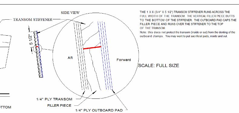

A minor incident I must also report. After a brief stint downwind where I could open up the throttle just a little, I heard a noticeable 'crack' coming from the transom. I immediately throttled off and took a look. I couldn't see any damage at the time, but after I had returned and had the boat on the trailer, I noticed a fine crack along the join where the transom strengthener and the aft decking meet. The leverage that the thrust made against the transom was enough to just cause a fine crack. So, other than simply sealing the crack, I now have to find a way to strengthen the joint. I think a stainless steel angle bracket will do the trick, but I will have to find one suitable.

As for the crack, most powerboats have a substantial brace from the top of the motor mount to the keel. The force, however, is not forward, but backwards. The prop thrust is pushing forward, but the leverage at the motor mount is aft, meaning the top of your transom is being pulled aft. The torque is enough to lift the bow. So when you are looking to install bracing, try to make it some type of triangle that extends from near the motor mounts to the keel. I have an 18 foot float boat that just uses a metal strap for this.

The crack in the transom should not have happened. I have attached a picture of the plan showing the transom detail. The torque from the propellor thrust is trying to twist the transom. Because the mounting screws are clamped to the transom stiffener, it is trying to open the joint to the filler piece. The joint between the transom stiffener and the filler is a butt joint, it cannot carry the loads imparted from an outboard. There should be an outboard pad glued over that joint to carry the tensile loads imparted by the outboard.
I highlighted the butt joint in red, the outboard in blue
