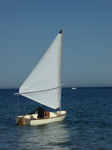

  2. Hello all. Hope this is allowed. Due to an unexpected bargain boat purchase coming my way I am now the owner of another, bigger boat, and have to sell my lovely, almost new Spindrift 11 "Aqua Bat" to make room. Built with all quality materials, she has only a few slight scratches after a season and a half of regular use. She comes fitted with a Leg-o-mutton sprit sail on a 3 section aluminium mast as per Graham's standard design. She sails great, easy to row, and moves along nicely with a 3.5 Tohatsu outboard motor (may sell separately). You can view my build log here: http://messing-about.com/forums/topic/8931-build-log-stevekos-spindrift-11/ Low Price: AU$1500 neg. with (oversized) trailer. (This price doesn't even cover the cost of materials!) I live in Adelaide, South Australia.

  17. I have just come home from a weekender away with some mates for a fishing trip. I took the Spindrift and got some sailing time in to really get some fine-tuning in. Firstly, the mod I did to the mast collar to deal with a bit of lee-helm worked fine. The boat is now about perfectly balanced in light air, but rounds up in a heavier gust, just as I was hoping. Secondly, the carrying capacity is great. I had myself and another friend and all our camping and fishing gear, food, water etc.on board and the Spindrift took it all in her stride, with no loss of stability at all. I'm going to have heaps of room for the river camping trip I'm planning for later this year. And I was very impressed with the speed and responsiveness in light air. On our return trip across the Coorong estuary here in South Australia, the wind was almost non existent. I resorted to oars for part of the way back, but even a hint of breeze was enough to get us sailing again. I'm loving this boat, and although I've really appreciated getting to know her in light conditions, I'm looking forward to seeing how she handles in slightly heavier conditions.

  20. After some discussion with Graham about my slight lee-helm problem, I decided that the easiest first step would be to extend the mast collar by about 20mm to put some rake in the mast. This has made it possible to have the mast either dead vertical or raked a few degrees aftwards. I had wanted to make the mast adjustable anyway, but just didn't initially, so this was what I did to achieve that: No turning back now! Timber spacers inserted and oversize to allow for some mis-alignment. (I can't drill straight holes by hand to save myself!). Not looking too bad. An extra layer of 6mm ply for extra insurance. And after some sanding and re-applying some undercoat... I tested out the fit and it's pretty good. I just need to make a wedge to secure it whether raked or vertical. If that isn't enough to deal with the lee-helming I will try the other fix that Graham suggested, which is to cut off part of the dagger board to allow it to rake forwards. I also had a bit of a problem with the rudder jamming when I tried to lock it. I discovered that the hole for the adjusting line was a bit too far around and the line was able to slide off the edge of the rudder. I'll try to cure that by making a groove along the edge of the rudder to reduce that likelihood. Pics on that later.

  22. Thanks Graham. I certainly had no trouble tacking and there was no undue rudder pressure, so it's only marginal. I am told that tightening the snotter in heavier wind will often fix lee helm too. I'll try the fixes you suggest and see how it goes then. I can also get another sail made with a slightly different cut to place the CE aft a bit if necessary. Sent from my HTC One X using Tapatalk
