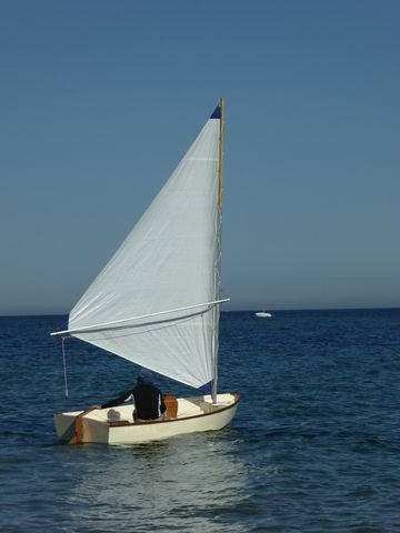

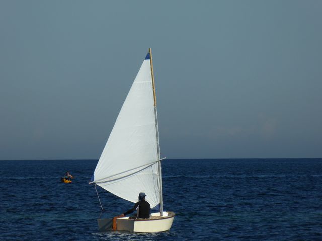

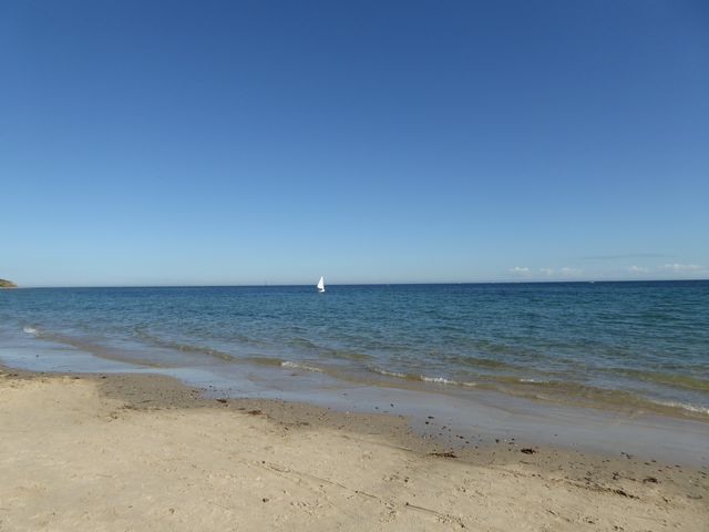

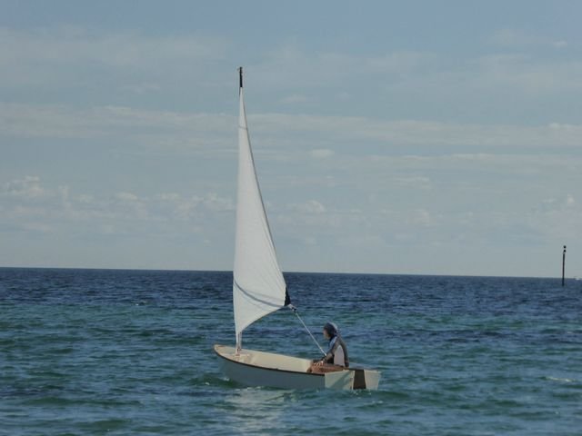

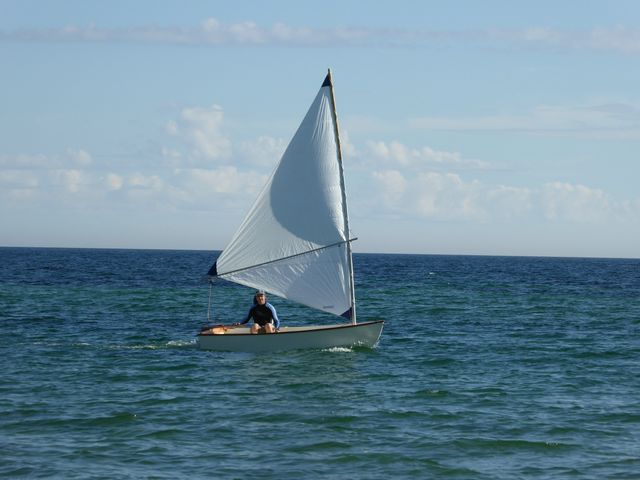

I was down at Seacliff beach today and saw this big kid with a new toy - he seemed rather pleased and I can't blame him as I was rather impressed myself........
Starting out
Sailing around
Well out
Zoomed in
Well done that man!
