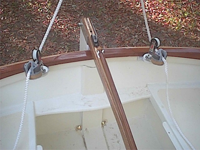

This is a CS-17, with a modified transom, but the construction details are the same. I used two 1" drains on either side of the keel batten. The inside view shows the drains just installed in their epoxy bonded holes and had a flange hammered into them, though still needs paint touch up.

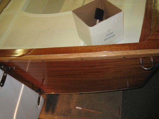

You can only see one drain on the exterior shot, but these are stock 1" brass drains. They come with a rolled flange, which is visible here. Just just to length, leaving about an 1/8" long, bed in thickened epoxy and hammer the flange over on the cut side, when it's cured, for a finished look.
The finished product received lever action transom drain plugs, each with a lanyard attached to the transom brace above them. They can't be left home, nor fall out, though you can forget to install them, which you'll quickly realize shortly after launch.
