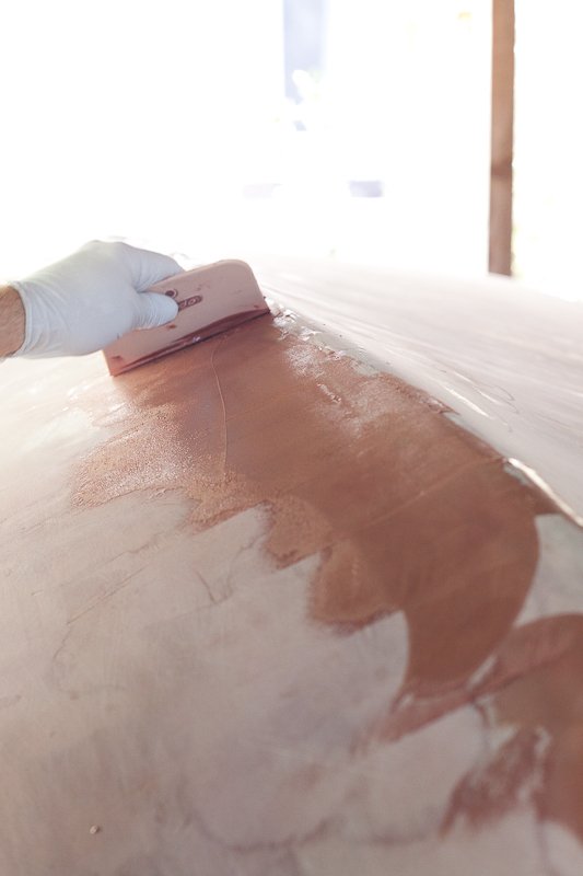

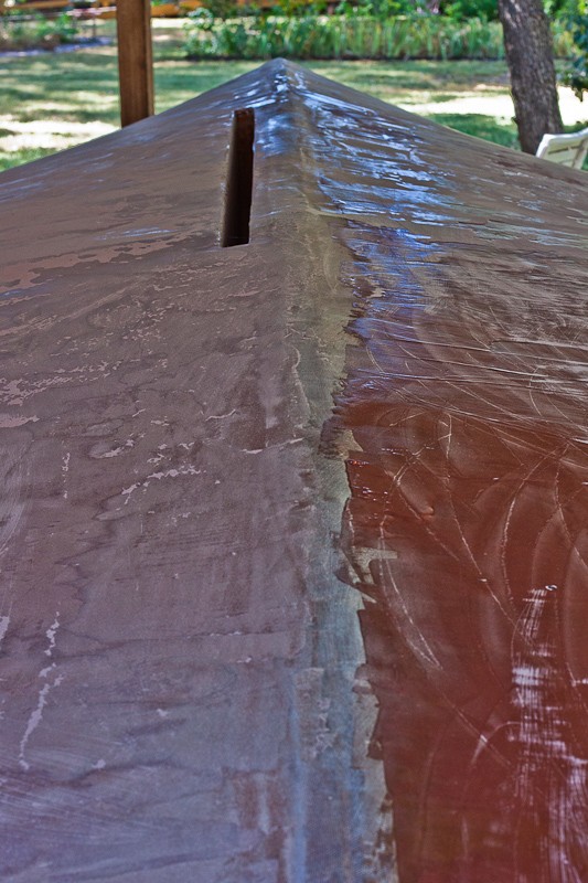

I just wrote a somewhat lengthy blog post on the fairing process for GoodFoot (CS20 #63).
It's my first big fairing project and I'm pretty much winging it, so any feedback on what I'm doing right or wrong would be a great help.
Here are a few pics to give a general idea. The blog has more pics and a fairly detailed description of my process.
The blog is here: http://goodfootsailing.blogspot.com/2011/08/fairing.html
Thanks,
Pete
Try a notched trowel. It will leave ridges of fairing and they are easy to knock down with serious grit sandpaper. #40 grit for me. Then you can fair again to fill the leftover grooves. The goop only needs enough viscosity to spreads so I mix a lot of micro-balloons in the epoxy = thicker than peanut butter.
Of course before setting out on the fairing adventure I eyeball the hull very closely to see if it really needs fairing. Unless you're building a racer or a show boat a little wookie in the surface isn't going to do squat far as the get-`er-wet and go sailing drill.
I'd coat the boat again w/ unthickened epoxy to seal the fairing material. Before this, though, I'd go back over the hull w/ the longest sanding board I could handle. RO sanders will give you a lovely smooth finish, but not necessarily fair. I'd use this last epoxy coat to develop my "rolling & tipping" skills to thoroughly coat the hull w/out being so thick it runs. Once this hardens, sand it again w/ your long board, looking for undiscovered dips & hollows. Repeat as necessary (where have you heard that before) until either you're satisfied, or someone takes the sand paper away from you. Doing this sanding, I wouldn't use much finer than 120 paper. You're smoothing, not polishing.
With what are you planning to paint the boat? If you're planning a 2-part finish like AwlGrip, they make an excellent epoxy primer that makes a good transition between your initial coating and the finish paint. Don't be surprised if you discover "new" hull imperfections when you sand the primer. That first coat can be a bit discouraging. Repeat as necessary until you're happy w/ the primer.
We can start a whole new discussion about whether you should spray the boat, or roll & tip it. That's up to your preferences & skills.
I guess this is a long answer to a short question. Good luck. Try to stay cool.
I'm planning to roll and tip an oil-based porch paint. I used this on my centerboard and was pleasantly surprised at how well it self-leveled. And after curing it seems to be pretty tough stuff. So that is why I'm wondering how far I need to go with the fairing and surface prep. I know if I were spraying a two-part linear polyurethane I would have to get the hull MUCH smoother. But with porch paint maybe not so much, right?
Fairing is more important than smoothing. A painted surface really shows the dips & hollows. As you've discovered, the paint will smooth itself if its reasonably applied. The way to decide if the hull is fair enough is to apply a coat of paint & decide how you like the results.
