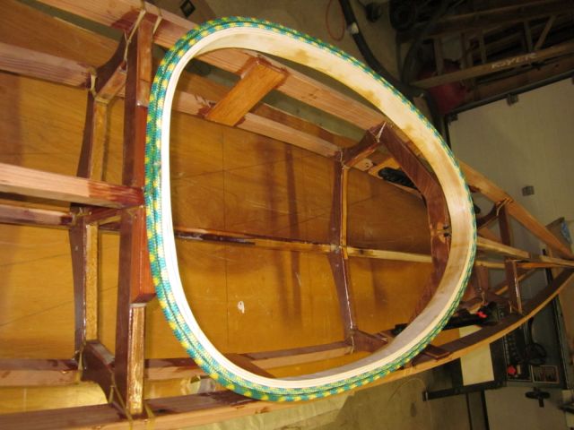

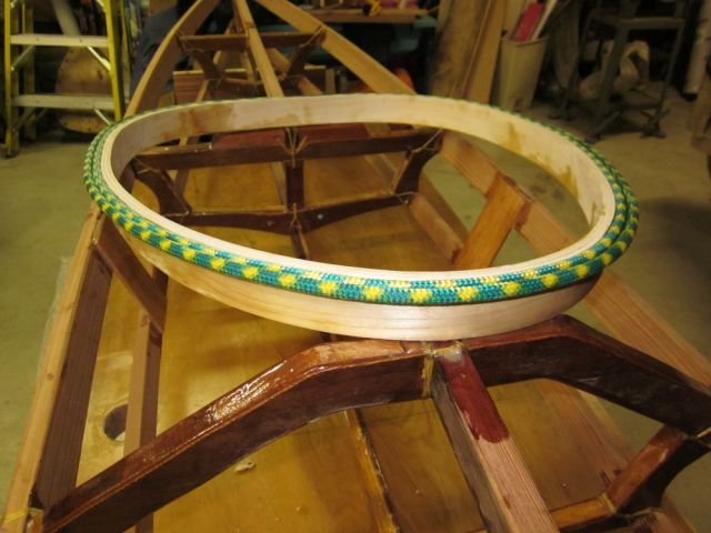

I built my coaming from 3 thin pieces of maple about 2 tall and then cut them down to 1 1/2 on the table saw after I removed it from the form. It might be 1/4" to 3/8" thick. For the coaming lip I epoxied 2 bands of 7mm stranded rope around the edge of the coaming. There is a small epoxy fillet on the underside. I will add some pictures tonight.
