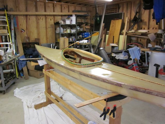

  2. I used varnish on my kayak and was not real happy the way it did not seem to fill the fabric and the voids it shows on top of the frame. Next time I would experiment with thinning the varnish on the first coat. A transparent stain might have helped even out the color. Not to worry, the more the boat gets used the less it will matter.

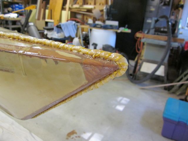

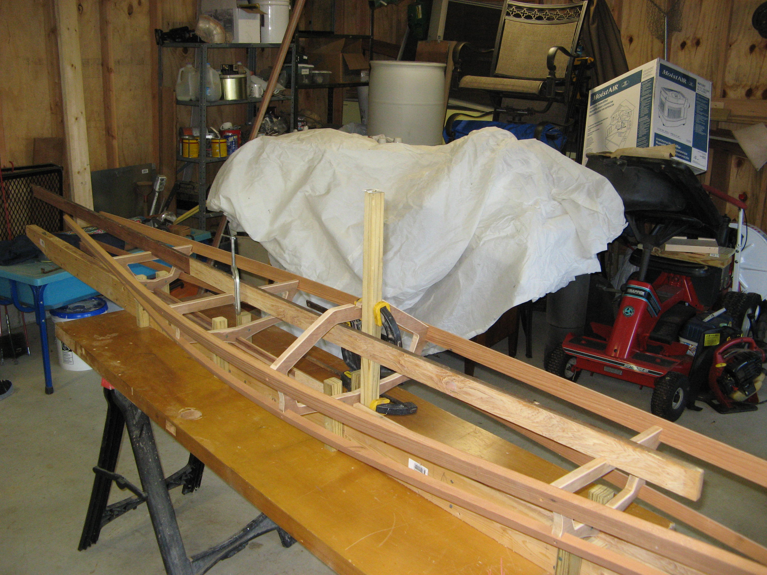

  3. Here is the Yostwerks Sea Flea 11 that I am building for my 8yr old son. I used 8oz polyester from the Kudzu Craft store and have 3 coats of Pettit Flagship Z-Spar 2015 varnish on it. It turned out pretty good. I think I should have thinned the first coat of varnish to get better fabric penetration. I guess I will try that on the next one. The redwood was reclaimed on a work weekend from the facias on Toledo Ski Club Lodge in Wallon Lake Michgan (20 ft clear and might I say free). http://www.toledoskiclub.net/ I would like to thank Jeff and his Kudzu Craft Site for all the great information about building boats. Next items are to add a seat, deck hardware and get it wet. Should be on the water next week. Dave Birkmeier Michigan

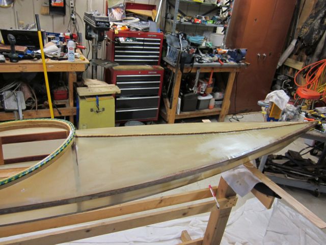

  4. Here are pics of the coaming I built.

  6. I built my coaming from 3 thin pieces of maple about 2 tall and then cut them down to 1 1/2 on the table saw after I removed it from the form. It might be 1/4" to 3/8" thick. For the coaming lip I epoxied 2 bands of 7mm stranded rope around the edge of the coaming. There is a small epoxy fillet on the underside. I will add some pictures tonight.
