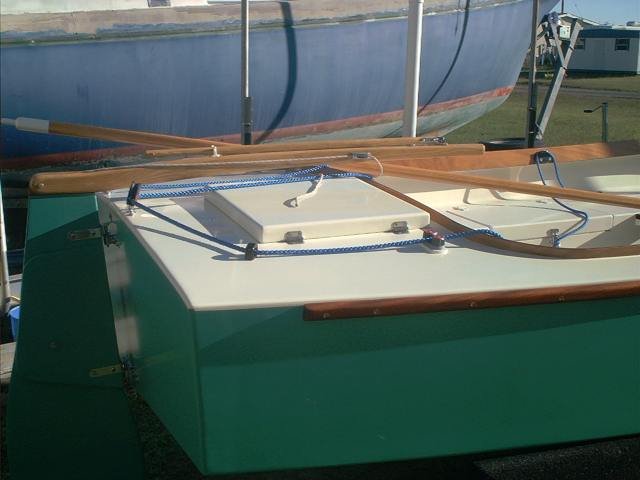

The tiller pivots on both the 17 and the 20 ( also the Princess 22). Graham sells a clip to hold the hot stick ( or tiller extension) and the extension swivel. You can steer with either the extension or the tiller itself, from a standing position.
I'd leave the rudder in the cheeks, use a up haul of some sort for trailering. PITA to reeve the down haul thru the rudder head each time. I wouldn't have a boat this size without an extension by the way.
Here's a pic of the tiller and extension on a 20-The 17 is identical
