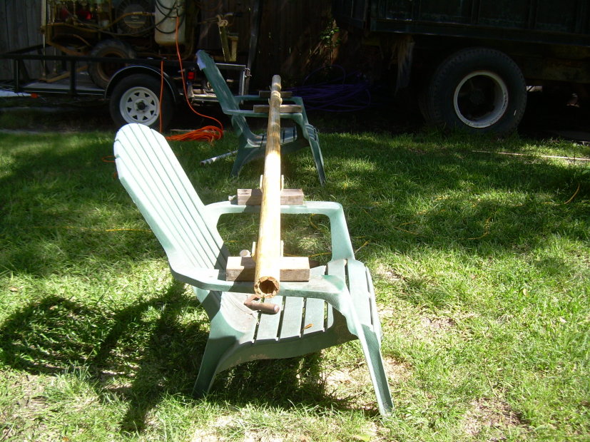

lbrewer Posted August 19, 2008 Author Posted August 19, 2008 While I wasn't able to take pictures of me herding houseflies, here is how the mast turned out: Quote

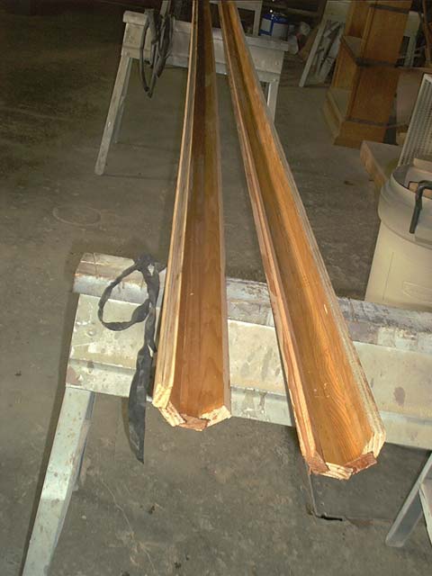

Charlie Jones Posted August 19, 2008 Posted August 19, 2008 ;D ;D Not to pick nits here, but gluing the mast in two halves was Charlie's suggestion, with pictures. ;D ;D Pic from 2000- Quote
lbrewer Posted August 19, 2008 Author Posted August 19, 2008 I knew I read it from your posts Charlie. I reread all of your posts on the subject before I started. It's a great idea so I figured PAR probably does it that way too. Quote
