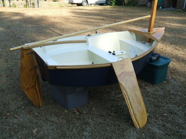

dale Posted July 28, 2008 Posted July 28, 2008 Congrats! She's a cute little dinghy. I thought I recognized her from the photos. I built a dinghy a couple years ago and though I didn't buy the plans, I drew my own from the pics of the Nutshell of the Bateau website. Here's my version with a link to the build process. http://good-times.webshots.com/album/552552831bfgnrG?vhost=good-times Quote
lbrewer Posted July 31, 2008 Author Posted July 31, 2008 That's awesome dale! I'd be interested to know more about her and her sailing characteristics especially. Is the LOA the same 7'9"? Bateau didn't have a sailplan for that design when I got it and I was a little nervous about trusting my own judgment in that regard. I'd like to try it though. Quote
dale Posted August 2, 2008 Posted August 2, 2008 Thanks. The LOA is 7'7" with a 47" beam. The project grew as it went along. I originally planned just a rowing dinghy but decided, why not make it a sailing dinghy. I designed the rudder and daggerboard after the free Bateau D4 plans and just made a square mast. I bought a Dyer Dow dinghy sail off ebay. It is 45 sq. ft. which is just a bit big for the dinghy according to what I see for other similar sized dinghies. As for sailing, I have never sailed a dinghy before so I have nothing to compare it to; but she is very quick. The boat is too light for me to sit on the side seats and it is very tight sitting in the floor with those side seats taking up so much space. And the tiller sticks in my back; even after making a shorter one than the original. Someone suggested a push/pull tiller which I believe would work fine. I believe she would be very difficult to right and bail if she ever went over. Quote
dale Posted August 2, 2008 Posted August 2, 2008 I was having trouble getting a pic to post the other day; so here is a single for anyone interested. Quote
lbrewer Posted August 3, 2008 Author Posted August 3, 2008 I sure do like the look of the side seats, though I can see why it may not be practical on a boat that size. I am thinking I might leave the side seats out and sail from the center seat and slide the ole butt port or starboard as needed. Have you sailed from the center seat? The fore and aft trim looks better in both your photos and mine when sitting there. Thats also the beamiest part of the boat and could be less tippy there and keep the tiller out of your back. Quote
dale Posted August 4, 2008 Posted August 4, 2008 I haven't tried, but I imagine I'd have to really duck when the boom came across. Quote
