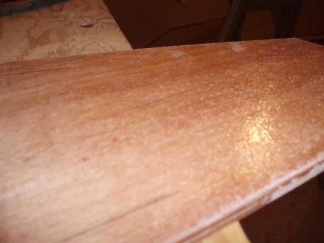

davidpm Posted April 9, 2008 Posted April 9, 2008 What am I doing wrong. I'm trying to coat some plywood with west 105 and 205. I use a plastic scraper to spread it then tip it off with a section of west roller just like it says in the video. After the first coat dries it has tiny little sharp nubs all over. They sand out and the second coat is better but still some nubs. I think these pictures are after some scuff sanding so the spots show better. Quote
Peter HK Posted April 9, 2008 Posted April 9, 2008 The first coat of epoxy always lifts up some wood fibres from the veneer- think of painting one side of a sheet of ply; it will result in a warped piece. The same applies to the small fibres in the surface veneer- affected by surface tension effects/shrinking of epoxy on the face/ etc they tend to lift at the ends and cause little spikes. Opinions about what to do about it vary- some say keep coating and it buries in the epoxy, others sand the first coat until smooth and then coat with little problem. I'm not using west system so I'm not sure if there is any problem related to its usage. The epoxy system I use has a viscosity lowering agent to add to the first coat to increase penetration- it really lifts the surface fibres but after sanding this layer it's perfectly fine. The plywood quality has something to do with it. Peter HK Quote
Tom Lathrop Posted April 9, 2008 Posted April 9, 2008 First off, it's not the epoxy, it's the wood. Some woods are worse at this than others and individual samples are different within each species. Here is what I do to minimize this problem and extra effort of sanding, not to mention waste of epoxy that winds up as dust. First, sand the surface with 220 grit and clean with vacuum. Put on the thinnest coat of epoxy possible. Do this with a squeegee and spread with pressure to make it thin. this will seal the fibers and won't give them enough epoxy to soak up and stand up. After epoxy sets up hard, sand the surface with 220 grit again and recoat as necessary. Some pieces of plywood are harder to work with than others but this method makes for less work and epoxy waste. If there are still some fibers standing up, I usually take them off with a wood scraper. Quote

Charlie Jones Posted April 9, 2008 Posted April 9, 2008 lol- I can answer that- He uses the epoxy from Graham. And he doesn't thin it I imagine- he just puts on the thinnest possible coat- rolled out well in other words. I do pretty much the same except I don't touch the wood with sandpaper till way later. I always use scrapers, then put on the next coat. I find it faster to use scrapers than sanding. Both ways work- obviously ;D But that first coat is GOING to raise nibs and bumps- little bits of wood fiber standing up- no matter what wood it is- Fir, Meeranti, Okume, whatever. Even solid Mahogany or other hard woods will have SOME of that. edited to say- OOPS- Just realized the question was meant for Peter, NOt Tom L. So maybe he DOESN"T use epoxy from Graham : Rest can stand as is. Quote
Tom Lathrop Posted April 9, 2008 Posted April 9, 2008 I have used epoxy from just abut all the well known sources and some not so well known. Lately I use Graham's epoxy because it is so easy to get and well priced. Actually, the brand of epoxy doesn't matter in this case. And no, I don't tip it out because that would not be possible. I squeegee it on so thin that tipping would have no effect. There will be far, far less nibs sticking up to be sanded off. The first cost has to be very thin or this won't do what I say it will. Squeegee, not brush, not roller and no tipping pleeze, gratuities are in included:D Give this a try on a small piece and see if it doesn't work. Remember, sand with 220 first, vacuum and squeegee thin---that's thin. No! thinner than that. A secret to using a squeegee is to have a good one. I use a rubber squeegee from Thalco Co. http://surferswarehouse.web.aplus.net/Merchant2/merchant.mvc?Screen=PROD&Product_Code=rubber&Category_Code=building OK, $24 for a 12" piece of squeegee sounds like a lot. It will make three good sized squeegees and I have had mine for 20 years and they will go to someone else eventually. If you forget to clean it, just sand a new tip on it. Quote

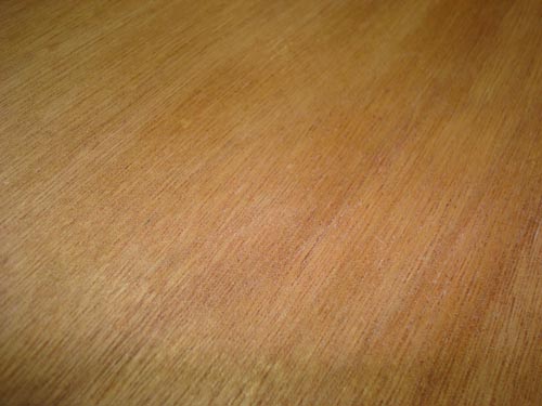

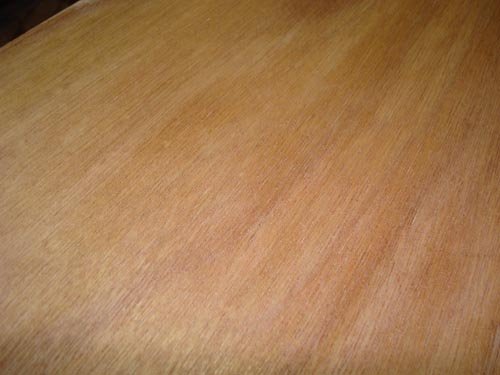

Tom Lathrop Posted April 17, 2008 Posted April 17, 2008 Here a couple of photos of a surface, first squeegee(ed) with a very thin coat of epoxy and then after scraping or sanding lightly. Very little effort and the next coat of epoxy goes on smooth with no fibers sticking up. I only use the Thalco rubber squeegees for coating and fairing jobs. For clean-ups and such, I use the cheap plastic ones. Plastic looses its sharp edge quickly. I use a block plane to make a new edge. Sanding plastic doesn't work well. A 36" piece of Thalco squeegee should last through several generations of boatbuilders. Quote
