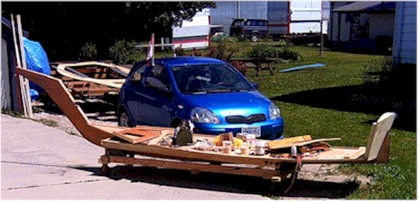

My Weekender weighed about 550 pounds, but it rolls very easily. The rub rails can get scratched and dinged, so having a helper with a piece of carpet or foam ready for putting between the floor and the rail helps. I had a couple of people come over, and they all watched while I rolled her over ... I think only two of us actually touched her as she rolled over.

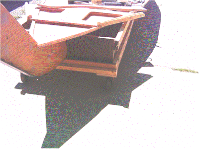

I made a dolly for my Weekender with casters at the corners. It made life a lot easier during the build.
My dolly started with 4- 8 foot 2x6s. I cut two in half and screwed the halves together. These formed the ends. Doubling the ends up gave me a large enough surface area to attach casters.
Between the end pieces I put in the other 8 footers using joist hangers and a couple of long lag screws through the end pieces and into the long rails.
After squaring up the frame, I screwed some scraps of plywood on at the corners as gussets to keep it from racking.
Initially I had just some supports screwed in place to keep the keel vertical. To put the boat in an attitude more like it would be in sailing, I blocked the keel up at the aft end with a scrap of 2x6 on edge.
After the bottom was attached, I added some supports on the sides to keep it from tipping to the side.
When it got time to flip the boat for the first time to glass the hull I got the boat off the dolly and modified the dolly to fit on the top of the boat. I set it up so there was a crossbar right in front of the cabin and another at the aft end that extended to the bottom of the cockpit. I placed the dolly, inverted, on top of the boat and held it in place with a couple of ratchet straps. We rolled the boat on a blanket and over on to its wheels.

Finished the frame of the trolley with the wheels attached. Waiting for someone to help me get the keel out of the basement so I can set it on the trolley. The trolley measures 12' by 6'-6". Once the keel is set on the frame, the plan is to add two cross beams at the 4' and 8' points the height of which will be adjusted to just contact the bottom of the keel. Then, vertical braces on either side of the keel to hold it fast. Then 3-D here I come!
Good job, Ken. Keep in mind the boat won't be that heavy so you don't need to over build the dolly. You'll want to move it onto a trailer shortly after you get it upright again. Still, it sounds like you'll be in good shape.
