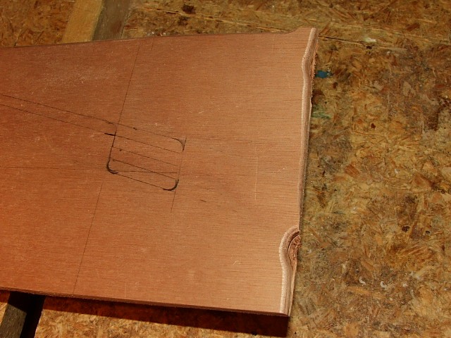

Howard Posted March 4, 2006 Report Share Posted March 4, 2006 These pictures are an extreme example, but show what happens if you try to "freehand" a roundover bit, when you don't have something for the guide to ride on. You could get a pretty good edge if you are careful, but any little wobbles are going to show. A router table gives you a fence and a nice even rounded edge. Quote Link to comment Share on other sites More sharing options...
