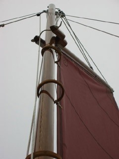

I use rope hoops. I used 1" three strand poly, formed into grommets that are about 8 inches in diameter. The larger diameter helps them slide up the mast better, and the three-strand poly is very ridged, so it holds its round shape properly.
on the side of the mast opposite the sail, I tied them all together with a line to keep them properly spaced, and to help lift them up over the hinge as I raise the sail.
The end result looks very very nice, and the sail raises and lowers without a hitch. I'll find some pictures tonight after work.
Noel
These were originally made as a quick-and-dirty way to get the boat out sailing ASAP. I had the 1" rope already, so I tied these up and found they worked quite well. Really, the only thing I don't like about them is the little orange stripe in the rope. But it doesn't bother me enough to motivate me to buy pure black rope and tie up a second set.
