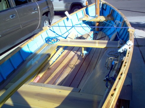

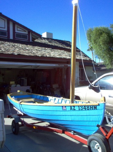

timnphx Posted November 16, 2005 Posted November 16, 2005 Ok, I finally got my camera back from my son who borrowed it to use on his Honeymoon to San Diego. I was able to take a few pictures of my boat. It is still in the sail-making and rigging process and trying to get it all figured out as the plans for this boat had nothing about rigging other than sail size, halyard size and mast and sprit pole size. So a real study to figure out as I have yet to do any sailing. Soon though, Soon as I plan to take a lesson or few now that the weather here in Arizona is ideal now. I posted some pictures in my gallary and hope they uploaded ok. Here is a few. Quote
mrthethird Posted November 16, 2005 Posted November 16, 2005 That is one sharp looking boat. I like the bright floor against the blue hull. Stands out nicely. Good job. Quote

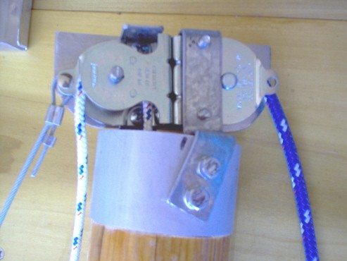

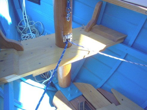

Stump Posted November 16, 2005 Posted November 16, 2005 That is one sharp looking boat :!: :!: :!: From looking at your pictures it appears that your lines go through you mast :shock: :shock: Is this true? 8) How did ya' do it? :? Quote
timnphx Posted November 16, 2005 Author Posted November 16, 2005 I built the mast using the Birds beak design which is using 8 pieces of Duglas Fir with a 45 deg cut on one edge of each, then glued together and then shaped. So the center is hollow but the ends are pluged with about a 6 inch solid piece. It is untested in wind yet but it is only 8ft and the mainsail is only 33ft area and a 12ft area jib will be used once it is constructed. Fun stuff. Quote

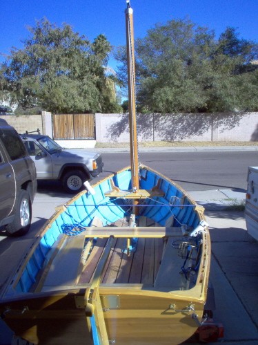

Charlie Jones Posted November 16, 2005 Posted November 16, 2005 ROFL!! birds mouth - BirdsMOUTH, !! One of the quickest ways I know of making a round or oval spar. Either straight, tapered or double tapered- really an easy job. A VERY lovely boat by the way. Got a picture from the side? Quote
john bowen Posted November 16, 2005 Posted November 16, 2005 Charlie, Look up Tim's past post, Oct. 22. Tim, She is good looking craft, nice work. Quote
Charlie Jones Posted November 16, 2005 Posted November 16, 2005 Better, but I'd still like to see a dead side shot so the sheer can be seen. I suspect it's gorgeous. The rest of the boat looks to be extremely nicely done. My compliments. Barry- I'm ashamed of you!! Telling Tim there might not be much response from this board cause most are building Stevenson designs!!! Even the Weekender people can appreciate OTHER pretty boats Quote
john bowen Posted November 17, 2005 Posted November 17, 2005 Charlie, I to would like to see more pic's, bow, port, starboard, keel and not to leave out the rudder. :roll: I only mentioned Tim's past post bacause I wasn't sure if'en you hadn't seen it yet. But yah, got some more pic's there Tim :?: Quote

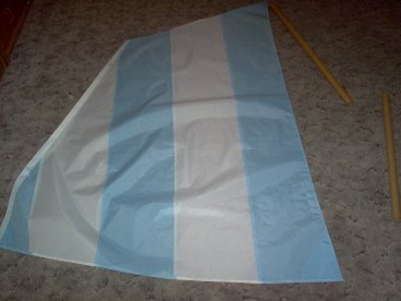

timnphx Posted November 17, 2005 Author Posted November 17, 2005 Here is a side-view sort of. I'll have to get a better one later after I do my week of hel... work on the paying job. Also here is my mainsail after sewing it together. It is a sprit rig with only a 6ft luff and an 8ft leech, 4ft head. Total of 33 sq ft area. I haven stiched the jib together yet but it will add only 12 more ft. Tim Quote
