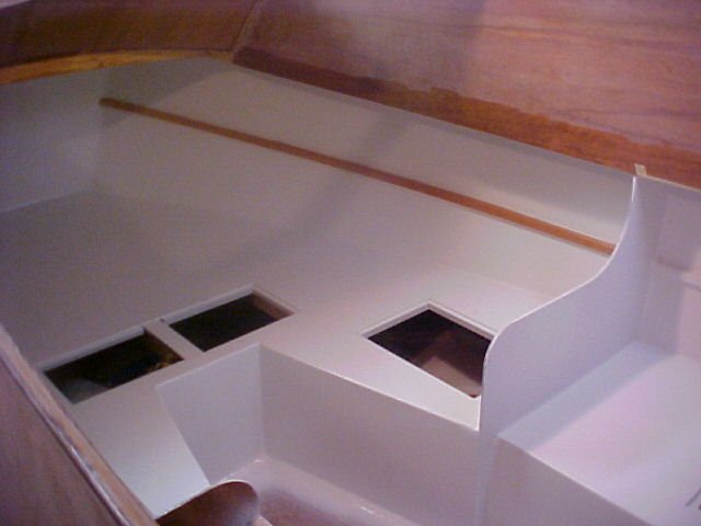

Got some done this week, not a lot but some. Both berths are painted along with centerboard case. Galley and #3 bulkhead are not yet. I don't know how I want to do the galley yet. As you can see the #3 bulkhead that has the tabernacle mounted to it is not painted. As I was sanding, I sanded through the epoxy in a few places so I have to recoat it and wait for it to age a bit before painting.
Got the rudder completed except painting. ( waiting on the epoxy again)
The rope on the center board needs a little more fairing.
I might get to lay that cherry flooring in the cabin soon. :D remember that that I cut for the cockpit. :oops:
The cockpit needs a little more touching up. Every time I think its ready for primer I find something that could be a little smoother. Then I usually sand to far and get into the glass and have to wait on epoxy again.

Scott, you are being very thorough with your construction process and it will really show off when all the parts come together in the not so distant future. Great job. :)
Thanks Ken and Oyster.
