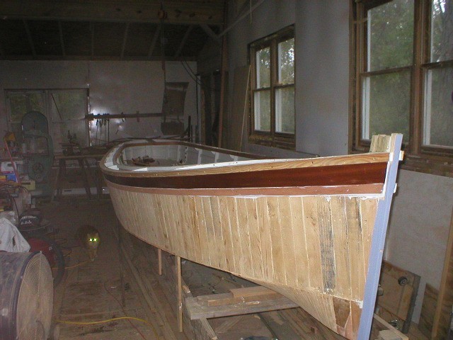

Guest Posted October 6, 2005 Posted October 6, 2005 Funny Capt. Ray the boat is nothing more than a migett oyster dragger style skipjack of who knows? plans. Quote
capt jake Posted October 6, 2005 Posted October 6, 2005 See! I told ya!! Scratch his head.......start cutting!! 'Scratch'! Looking good Mr Oyster! Quote
adla Posted October 6, 2005 Posted October 6, 2005 OysTEr... looks fine...just fine. What is the er, beam? (is that what i mean to ask?) How wide is it? Don't mind my dumb questions...i just spent a week in hawaii with friends (one that likes to sail a LOT) and i am anxious to MovE thERE (in my dreams)....but back to your project...what is the benefit of the small sticks (strength/flexibility?) and how wide is she? a. Quote

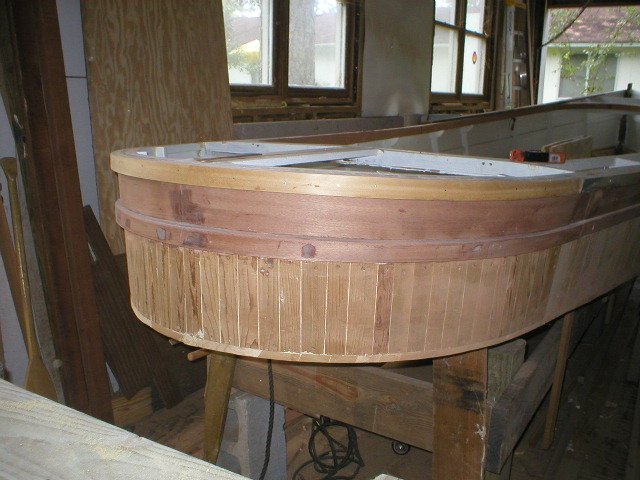

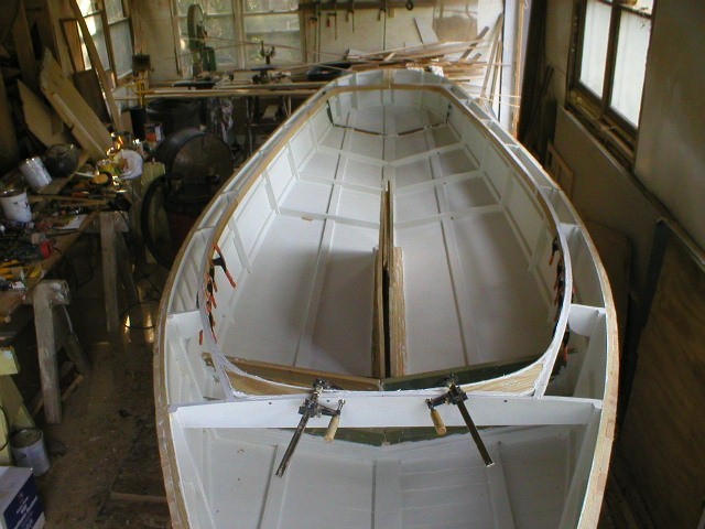

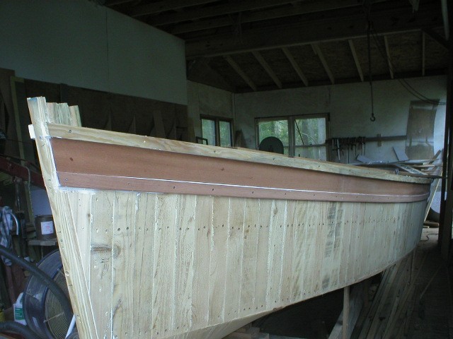

Guest Posted October 6, 2005 Posted October 6, 2005 Actually Capt. this one is from Thin Air Designs. Adla, the boat is 23 x 70 beam on the waterline. The small strips in the stern is because of the curve. The sides and bottom consists of 3 1/2" wide pieces, except in the extreme ends of the hulls, all glued to longitual batterns, as is done in most cold mould constructions. Instead of plywood, I like to use solid stock when I can, and also its free in this case. I recycled it. The framing is still done as a traditional built boat is built with a bit less in bulk, since I am laminating a layer longitual from several reasons, one being the hull actually is more stable for trailers unlike a solid 3/4 planked hull with huge seams to swell and contract over time. The cross plank is in the style of the boats, and is and was also used in construction when a person is cutting through random qualities of materials and can be done by one self. When the boats were built as simple wokr hulls, you could replace bad ones with ease, too. Now for the toppings on "Popsicle" 8) Now as far as you moving, anyone can do it. It may take a bit of planning, but its done all the time by people stagnet in their surrroundings. Quote

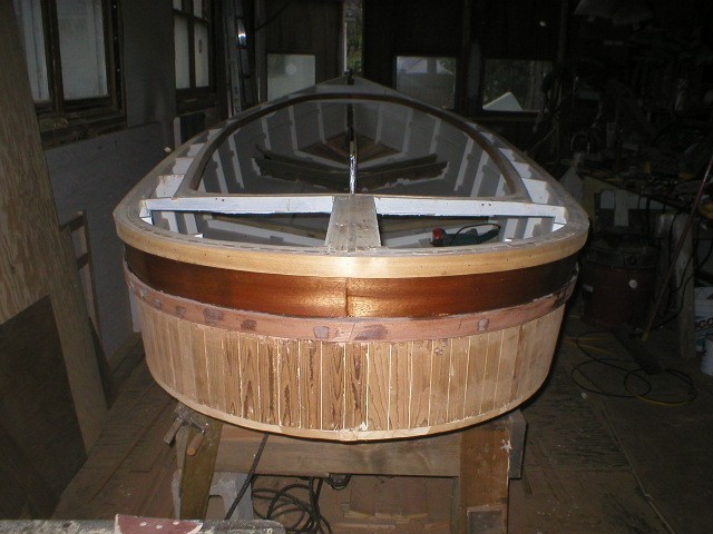

Guest Posted October 21, 2005 Posted October 21, 2005 Well I am moving right along. The coaming is very simular to my 20 except I kept it wider in the foward section for a working type cabin on it. Click twice for clarity. Quote

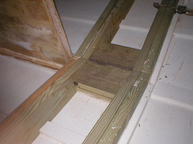

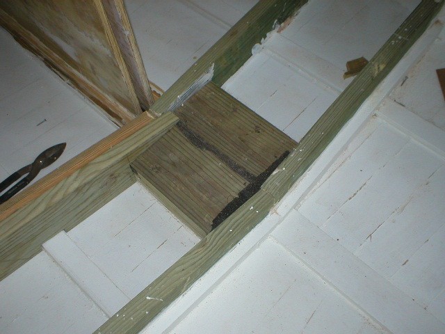

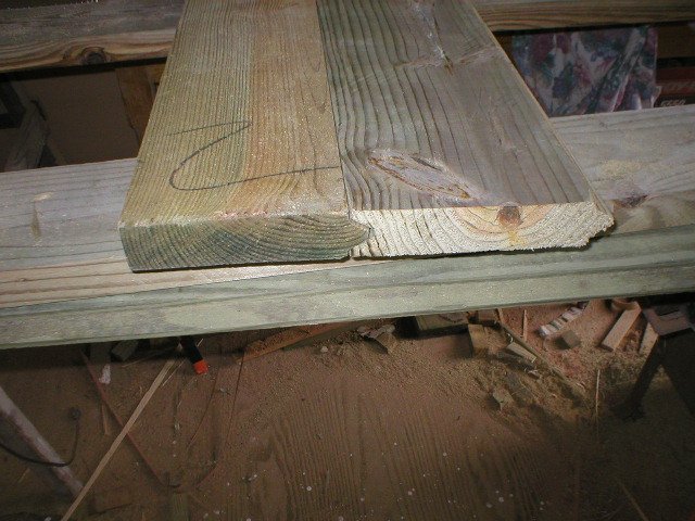

Guest Posted November 15, 2005 Posted November 15, 2005 Well just a small update on one page. A couple of these have been floated on some threads, but thought i would keep them in one place. I have the band ready for varnish, with the accent mouldings on which will get contrast paint colors. I have also fabricated the mast step. I kinda make it substantial because for all intensive purposes, these are unstayed masts, even though they have side stays and the jib has a wire in them. I make them out of cut off seawall materials which is thrown away, and works great for my job. Its T&G material. So I use two pieces, two layers, run the tongue off of one and the groove off the other one and double them up for the step. This is secured throught the bottom and fastened through the initial bottom frame. Then I double them up, allowing for the doubler to overlay, locking them in place, fastening them the existing frame, keeping them nice and secure for all situations. Quote
