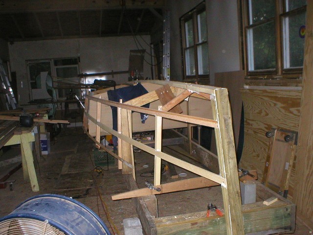

Are you going to plank the stern or use ply? Wow, what a challange, did you steam that?
I will plank the stern. I laminated the frames for the round stern. I did not want to hijack the other thread further. I will only add sustantial single shots and not consume so much bandwitdh on this one. There are others coming that have a lot to add now, and I do wish them as much fun as I am having with my new hull. Cheers and Beers :)

From my reading, not practical experiance, it looked like that was the perfect setup for planking.
Have fun and do keep us poor wannabes in the loop. :wink:
Actually for the smart people, its the absolutely perfect setup for simple sheet plywood bent around it, gluing up layers as was done with the frames. But that does not fit my discription. :lol: At this point I may be required to skin a layer over the cedar planking as my number count of board feet after cleaning up the wood for the thickness that I will required, will require a layer which may be better for me anyway for this boat to sit on a trailer and to travel over the road better.

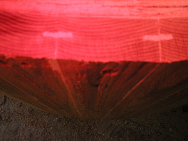

Actually we have found that using a flexible caulk, in the sawcut, it does just as good, especially for trailable boats. I have been using shiplap on side planking with no problems in two boats of solid planking, depending on the types of wood, but with this being the curved as it is, it just is too much work and would not have actually fit as well as what you have is actually compound curve since it does have some flare out being carried from the sides.

So, the caulking doesn't work loose? Are you using 5100 or something else? (gosh I love picking your brain :wink: )

I am using Bostic 920 on this boat. It dries in a day in this heat and sands, and by the case cost about one dollar more than the PL product.

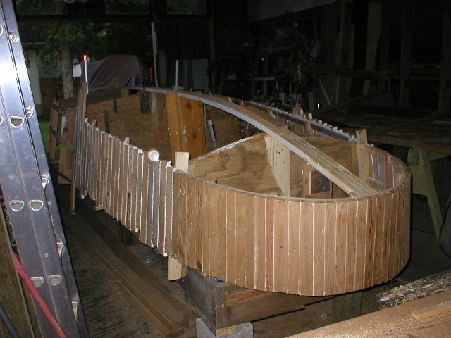

Well I am headed to the bow with the planking, and have all the longituals and ribs in place. I have ripped the planking out of the knotted red cedar, leftovers of course, making nice clear pieces cut between the knots, that will be skinned with longitual mahogany, 1.4". I have 1/3 of the hull sides done today. Fun day!!!!!!!
Yes Tom, I do understand where you are coming from. The planks end up around 1/2"x2 1/2" with a pretty liberal amount of caulking on both sides of the seams, worked into the sawcut, and placed in place with a gentle nudge against the previous one. This has worked for me in most trailable solid planked hulls with dried and stable woods in the cedar family. Of course I am a fanatic about primers, multiple coats, like 8 coats in some cases . We shall see......

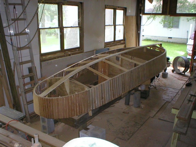

Got "Popsicle" planked up to the bow area which will require the usual skipjack style stepping in of the small planks. With the help of a forum menber, in casual conversation. unbeknowings to him, this boat has a name already attached to it unlike the present one which has yet aquired the proper one. He said it looked like a bunch of popsicle sticks, and it has stuck the right nerve. Of course it still needs some sanding after the caulk cures properly, and will be skinned over with planks fore and aft 1/4 inch. This one will get a varnished bellyband.

All planked up and ready for the mahogany skin on the sides. Click twice for clarity.
