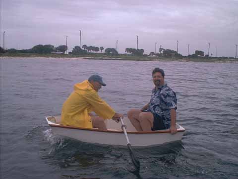

in the Mini I had to install two sets of row locks since with a passenger you have to sit well forward, particularly if that person is large.. The guy in the stern in this pic goes 255 :lol:

The 10" is an average for different size rowers on a Spindrift 10. Without an adjustable arrangement you have to find the best average. In practice it is not that critical especially on an S10 because it has a fairly large footprint on the water as compared to Charlie's Mini which has to be trimmed more carefully. A person with longer arms can sit more forward on the seat and a smaller person vice-versa to be comfortable without upsetting the fore and aft trim.
