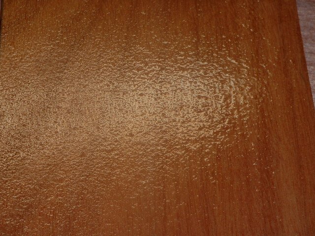

Howard Posted July 5, 2005 Posted July 5, 2005 Maybe now is a little late to worry about it, but everytime I coat a new piece of okume with epoxy, I'm left with a very rough surface....presumably a bunch of little air bubbles coming out of the wood. Probably a good thing, as the epoxy is being deeply absorbed into the wood. The downside being it's a real pain to get sanded back smooth. Anything I can do to avoid this? Quote
Guest Posted July 5, 2005 Posted July 5, 2005 Thats what is known as outgassing. If I understand it correctly, you are precoating your plywood? I will wait for further comment before a comment session. This has nothing to do with satuation. Quote
Howard Posted July 5, 2005 Author Posted July 5, 2005 Pre-coating and coating in place. But due to the rough texture that's left, sanding is a chore and in tight areas, would be next to impossible to get smooth. So I'm trying to pre-coat as much as possible. It's also easier to get a smooth finish when it's laying flat. Yes....I'd say this is a variation of outgassing. I've seen large bubble outgassing on other woods, but okume...with it's porous surface, seems to be different. Not quite a froth...more of a gritty feel to it... and reminds me of a raised pebble finish. It would be an effective non-skid if left as is. Not too bad sanding down the few pieces for building a dinghy, but if you were doing a bigger boat, this would take the fun out of it. Quote

Howard Posted July 6, 2005 Author Posted July 6, 2005 Texture is easier to feel than to see, but I made an attempt to photograph it. I never considered just covering over this, assuming perhaps it was small bubbles (but doesn't look or feel like bubbles when you study it closely). I'm going to give Charlies scraping trick a try, and also do a sample with Oyster's roller trick with D-N-A. I've got several large panels to go and would really like to avoid all that sanding. However, once that first coat is on and smooth, the subsequent coats are easy. Only bubbles in those are the ones I whip into the epoxy when mixing, and I'm getting better at that. BTW...I'm using RAKA with slow hardener. [/img] Quote
Guest Posted July 6, 2005 Posted July 6, 2005 No problem Charles, I had replied to his original comment and read the second comment as to believe the little fisheyes were coming into the finish. The photo shows a bit different on my screen as if the epoxy is a bit heavy in just one coat, leading me to believe that a heavy nap roller is being used too, causing the rough texture that seems apparent here, which is normal. Tell us more about your roller head. There shows some white spots, on the right, as if you are getting some of those in the coating, too. Quote
Howard Posted July 6, 2005 Author Posted July 6, 2005 I'm using a nylon bristle chip brush. I spread on enough to get it evenly wet....making the dry spots go away. I then try to drag off the excess so that it dries to a smooth, even surface. On the sample, I don't see any white spots. I also got out a magnifying glass, and I don't see any bubbles. It's more like gritty granules. I'd be glad to make up some samples and mail them to anyone who would like the examine them in person. Send address to: haudsley@tranquility.net Quote
capt jake Posted July 6, 2005 Posted July 6, 2005 It appears to me to be some sort of contamination; maybe some dust left in the pores that is getting pulled out with the epoxy?? I whole heartedly agree with the scraper for working cured epoxy, it gives a nice finish. FWIW, I use a 'Bondo' plastic spreader to apply epoxy. It moves it around well and leaves a smooth finish to begin with (or as near smooth as I think you will get). I have also seen a trick used with Kevlar thet may work here; lay plastic sheeting over the epoxy and then use a brayer (smooth roller) to press the sheeting to the epoxy. When the sheeting is removed it leaves a glossy smooth finish only in need of light sanding. Quote
Barry Pyeatt Posted July 6, 2005 Posted July 6, 2005 What I'm seeing here doesn't look like bubbles to me either, it looks like textured epoxy. I've not seen that by applying with a chip brush, only with longer nap rollers, but obviously it happens. But then, thinking back, I've never tried coating a larger panel with a brush. I've not had grain raise like that either. I'm wondering if the epoxy is beginning to gel and the brushing is pulling it a bit as you go over it. We used a lot of "Poor man's peel ply" in finishing out large plywood panels with epoxy. As Capt. Jake just stated, it is heavier gauge polyethelene plastic. The clear stuff for construction sheeting. 4-6 mil generally works good. Sometimes referred to as "Visqueen." Commonly used for ground cover under concrete slabs, etc. We rolled the epoxy on the panels, (they were generally hardwoods for decorating) with a foam roller or as Capt. Jake stated, with a plastic spreader. Then laid the poly film over the panels and rolled it out with a smooth rubber roller to give a complete contact with the surface. Once cured, the poly just peels off leaving a completely smooth surface. Using actual peel ply fabric will leave a slight texture to it which is great for laminting or applying glass later on. This technique is also used by some glass shops (Boat builders included)that do a lot of layups over plywood to give them a really smooth surface that doesn't need much to get a really nice finish on it. We knocked any ridges or high spots off with a scraper first and then used a long board to sand it completely smooth. Like Charlie, I'm a strong advocate of using scrapers rather than all that sanding. Lots faster and less work for a smoother finish. Quote

Barnacle Jim Posted July 7, 2005 Posted July 7, 2005 Hi Howard, The orange-peel appearance of your epoxy coating appears to be identical to what I encountered as well. Like yourself, the wood I used was Okume. Unfortuantely, I was not able to solve the problem. In fact, I ended up scraping all the epoxy from the panel, and then applying polyurethane. It was a long and arduous job. Here are a couple of suggestions Quote
Howard Posted July 7, 2005 Author Posted July 7, 2005 Tried a test panel yesterday. Actually, 4 of them. They were: Okume; marine fir; luan (actually...underlayment for vinyl flooring); and some birch veneered particle board crap that came as backing for a set of cabinets. Interesting response, as the okume did exactly the same thing...rough pebbled finish. The fir and birch were also slightly bumpy, but not anything like the okume. The luan, true to form, sucked up the first coat and had a mostly dry surface, with little "streams" of slick epoxy where it was put on thicker. Interesting that the run-off that was drug off to the side and puddled on the plastic sheet below and to the side of the panels was clear and smooth. No bubbles or pebbles in that. So I still thinking this problem is somehow related to okume and epoxy, and may be something like a raised grain response. But once you get rid of the grit, it's "clear sailing". Subsequent coats go on as smooth as you make them. Charlie's scraping worked, as does my original method, which was waiting for the stuff to harden enough to sand, then knocking down the tops with 60 or 80 grit sandpaper on a random orbital sander. It's just more work. As I only have 3 panels to go (6....if you count both sides), I'll do what I've been doing. If I was to build a larger boat, with many more panels, I'd have to consider switching to a different plywood; covering with the plastic sheets, or see if something like a drum sander would work to knock down that first coat. If it's perfectly smooth, that release film sounds good. The plastic sheets always seem to have wrinkles in them, and that leaves ridges and valleys that are very hard to sand back to smooth. Thanks to all for your comments and advice. Howard Quote
