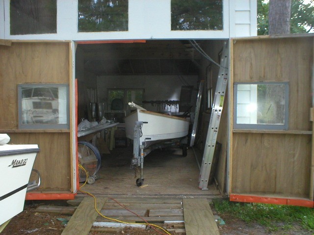

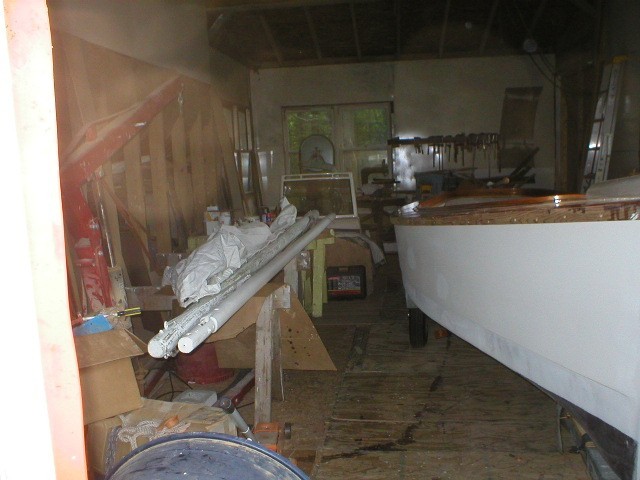

What you see is a 66 inch beam boat, 20 foot without the bowsprit and rudder on it, and a set of horses, 4 feet wide in the floor space of 16x24, without my tool addittion in the rear. You wll find that I have about 30 inches around the boat on the trailer, which the fenders are the same as the beam. I hope this give you an idea of what its require to be marginally comfortable. Its not bad, but laying off requires some area to stand back and look at your work. I do have access to swinging the two doors into themselves and the top panels open up to allow for 11 foot of access with 12 foot open ceilings. My wood storage is off to the side with its own entrance to it from the outside.
Double click on the photos for clarity. DOn't know why but it just does... :)
