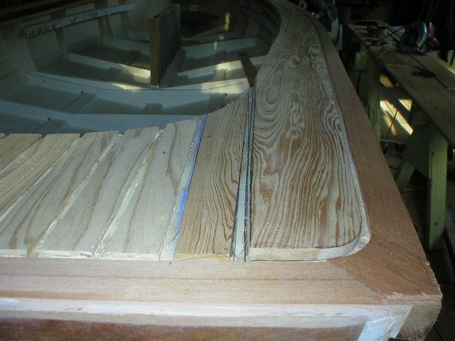

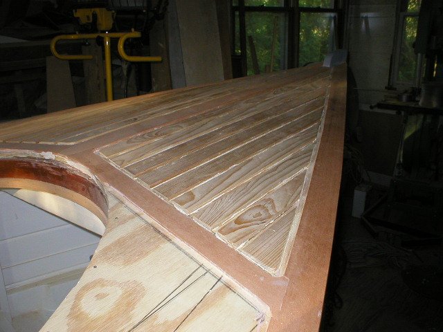

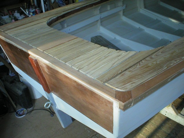

These shots show the style layup that I use with most any wood decks and can also be used for your hatches. A pointof note, I wanted some heavy grains so I used some flate sawn with some vertical grains with a wider glue joint, which I think makes a smaller boat or smaller jobs not look so "busy". I still have the main part of the rub rail to install over the filler strips, saving me some added costs for good hardwoods if purchasing the good stuff.
Great info Oyster. Your boat is looking fiiine.
