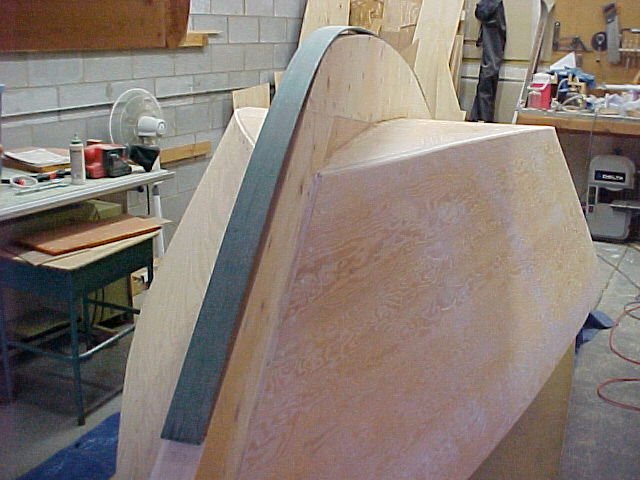

I cut tow pieces of UHMW 3/8 x 2 x 48 and mounted them on the keel. One up front and the other about a foot from the aft end of the keel.
Tonight I will remove the strips and drill the holes out to fill with epoxy. I think I'll be glad I put this on - hopefully it will save on the wear from beaching and trailering - we'll see.

Rolling something on - you always have the good ideas - but alas.... just a little late for me - I already attached the strips on the keel bottom. Here's the pic I promised Jan - if not already viewed in a different post:
[attachment over 4 years old deleted by admin]
