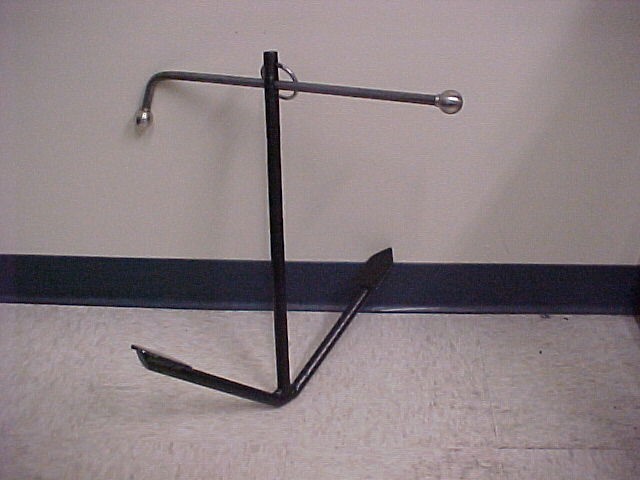

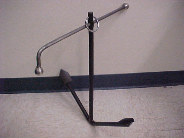

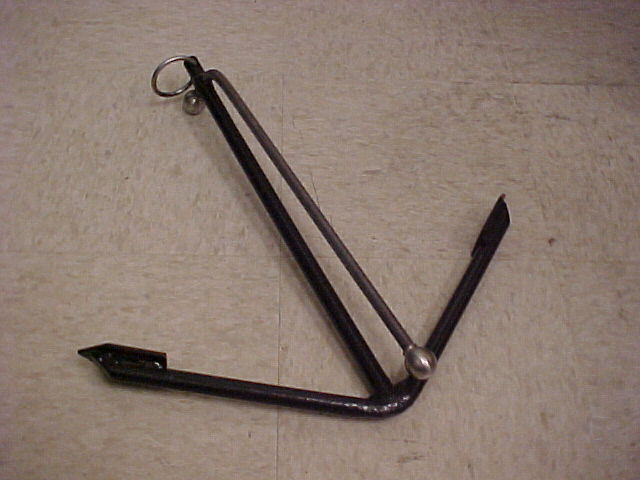

  10. The basic material is metal the shank is 21 inches long by 3/4 inches round the flukes are 20 inches from point to point the stock is 21 inches by 1/2 inch from ball to ball with the bend the flukes are 1/8th inch thick by 2 inches wide by 3 1/4 inches long to the point the fluke arms are 3/4 inch round all welded and the stock hole is welds down each side to make it stronger from drilling a hole for the stock, painted it with rust-oleum black hammered finish. we just cut all the metal to the right lengths layed them on the concrete the way we wanted and welded away.
  11. Hi Captain Jake, yes I think Ill hang it up front off the bow sprit with some oak cut outs on each side that hold it in place. most of the places we sail around here have sandy bottoms, dont think Ill have a problen getting it stuck.
  12. Well my friend and I welded a few kedge type anchors the past few days mine is about 8lbs the next few will weight more, we thought it would be fun to make our own. next week we will try them out. here are some pict.

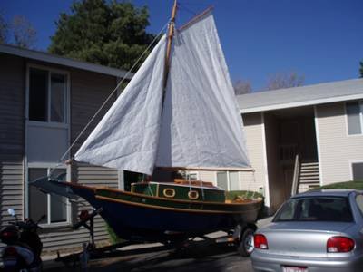

  13. Well what a trip we had we went up to the Sawtooths here in Idaho to a lake called Stanley lake. We arrived Thursday morning and set up camp. I put the Brick in the water on Friday and what a great day for it. The wind was constant and would gust up to 25 mph! At first I thought it would tip, but it was very stable and I have found I need more sail! It sailed excellent! Because of how easy it was to sail both my daughter and my wife actually sailed it! We all had a great time! Here are some pics for you to see!
  14. HI Frank and Oyster, launch date will be next week around thursday were going camping up in the mountians so when it hits the water I will take some pictures. Oyster you were right the girls were just an excuse to build another boat but as it turns out the girls cant wait to sail in it so I can see in the near furture I will have to build another one for myself, plus my wife is excited about the boat and thats always a plus.

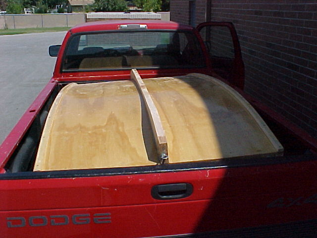

  15. About a month ago I wanted to build a small sailboat for my girls they love sailing so I found some plans for a bolger brick. so hear I am just a few days from finishing the boat. just have to finish painting then do the rigging and finish the sail whitch will be a gaff set up, and better yet it fits in the back of my truck. just a few pics.

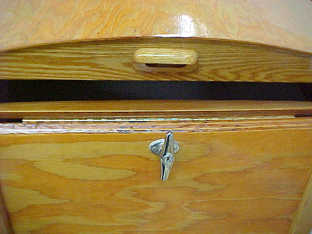

  24. Thanks everybody on your imput I wanted to have something that looked good and could lock without having a big lock with a hinge on it, it makes me feel alot better when I leave the boat parked or left outside before a trip with all my stuff in it, my front hatch has a lock on it to Ill post pic as soon as possible.
  25. well the lock on my door is a garage door handle lock I just added a longer piece of metal so when you turn it in the lock position it holds the upper part of the part of door closed, and by the way Capt Jake things are looking great on your progress keep up the great work great to hear from you.
