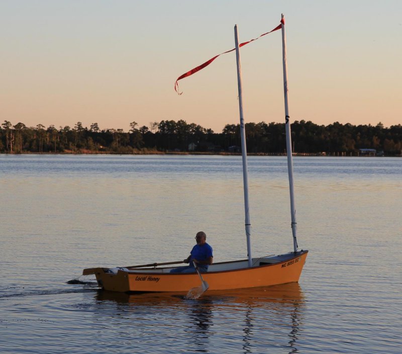

Has anyone tried an unstayed gaff rig on CS17 or CS20?
Ideally, I would like to be able to set one up with only a lite jib stay and a shorter wooden mast for single hand sailing and beach camping.  I would of course be keeping my two aluminum masts so I can sail as a cat ketch when I like, but for solo overnights I was thinking the gaff would be easier to reef under way, go under more bridges with its shorter mast, and allow for a simple boom tent camp setup.  Also would be easier to row on my own without straddling the mizzen mast.
Thanks to another member for the photo of his old boat...
