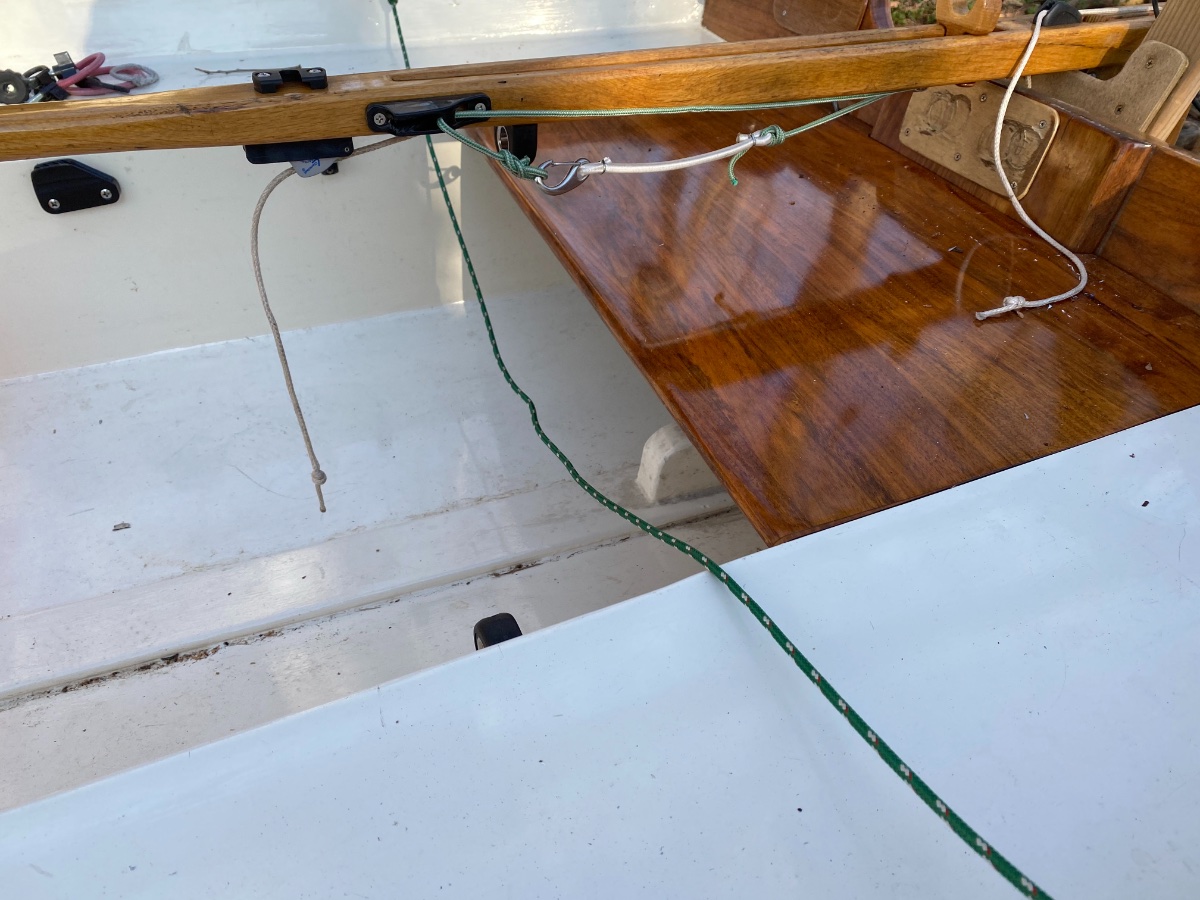

Bob,
I finally got out for a sail a got a few photos.  There is an important detail regarding where the mizzen sheet lands on the tiller.  It needs to be located vertically inline with the rudder pins (not on the rudder head) or it will pull the rudder in the direction of the mizzen sail.   Moving the mizzen sheet block does result in uplift of the rudder which I solved with a tiller downhaul.   This arrangement has worked well on my boar for several years  and I'd recommend it for your Texas 200 trip.
Thrillsbe is spot on regarding the reefing - same as the CS series except you need standing blocks to get over the cabin top.
