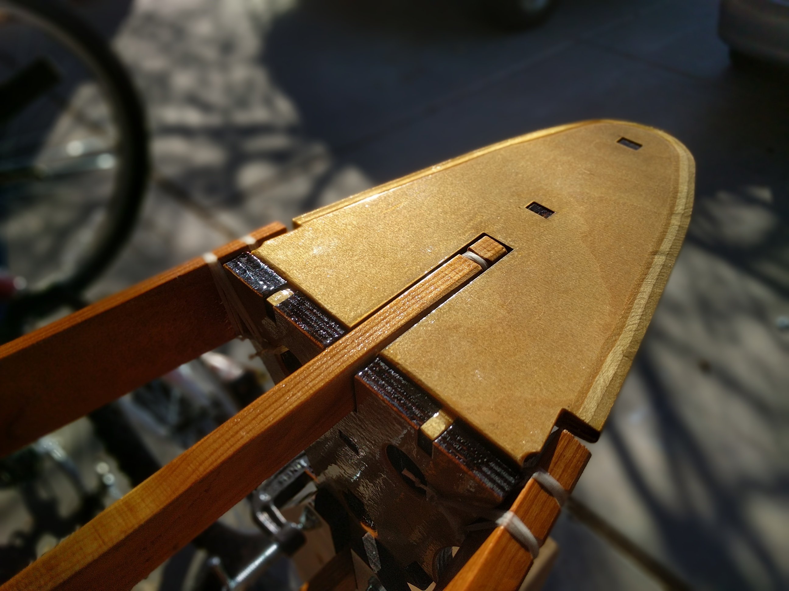

Laser works well and the edge charring is superficial. .005" kerf. Clear protective coating over the black edge looks good as well. That's my opinion. The parts smell burnt until painted. My guy isn't currently taking new clients though. These parts were made that way.
