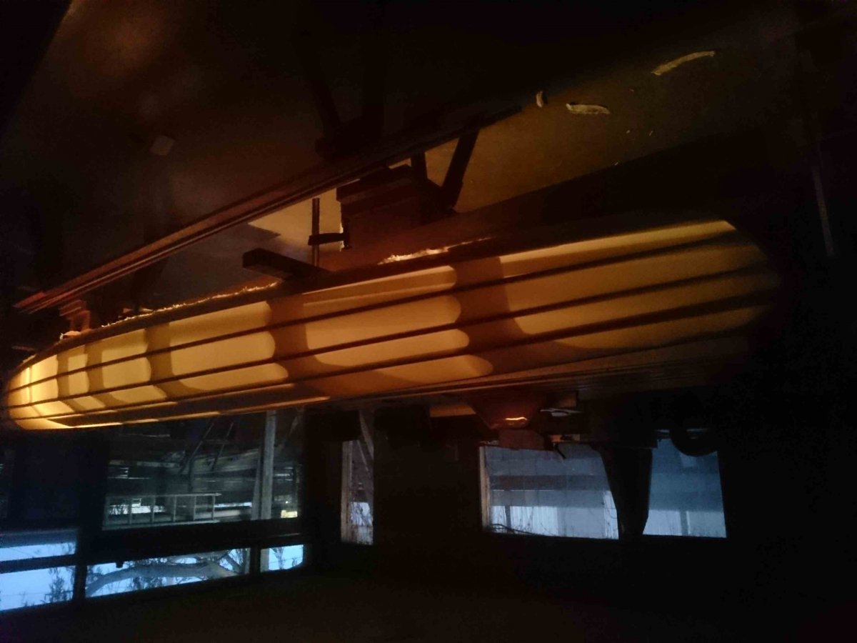

  2. Launch day at the Yarra river. We call her phosphorescence. Found a canoe launching jetty on the river with the carpark only 60m away. I was first out as I figured if it is going to sink then it should be the captain who goes down with the ship. Well it didn't leak a drop nor did anyone capsize. The canoe is an absolute delight to use. Light, fast and stable and turns OK. I can see it part of the family fleet going on camping trips. Four of us had a go from 50kgs to 100kgs (I was worried about my seat but it didn't break with 100kgs) The seat is very comfortable though I will have to fashion a thwart/backrest as the skinny temporary one digs in to the back. I will make one that extends up level with the top of the gunnel and maybe a little lower to give about 100mm of support. The only other negative thing to say is the white fabric being white and uncoated inside is prone to getting grubby particularly as the Yarra river is mud and bird shit on the banks. But I am really happy with it and am keen to get some more water time. A great design Jeff. I have just made a greenland paddle and am working on a hoist system in the garage now.

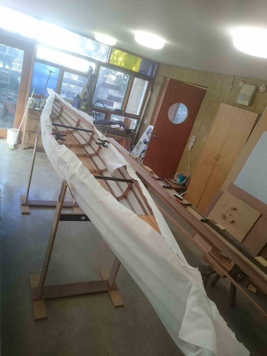

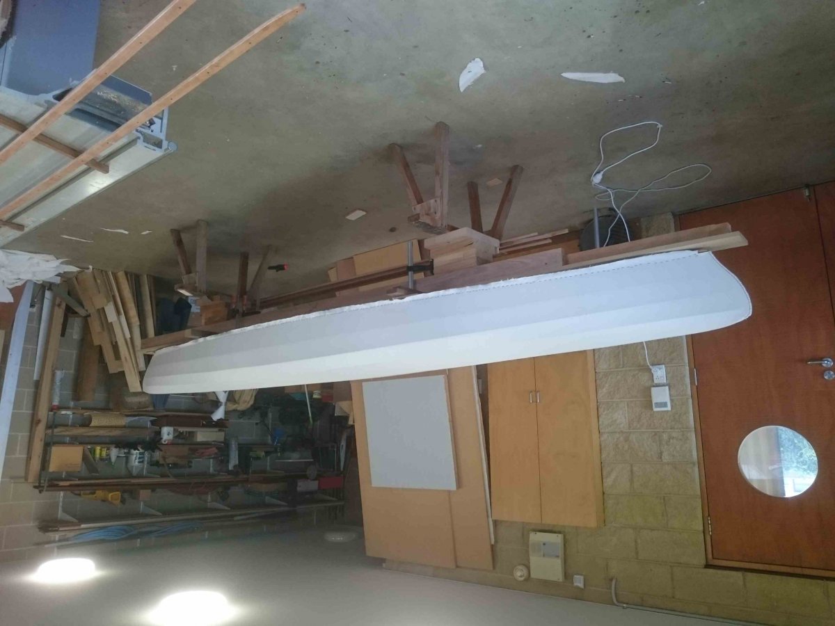

  3. well the stonefly is finished. I will add the remaining construction photos here then post in the launch section. The final job to do was to coat the fabric using oil based exterior grade clear polyurethane. I put on 4 coats which is slightly yellow/green but overall not a bad look. I was a bit disappointed to notice s few wrinkles in the side after a few days. Nothing really bad but they show up and would look better without them. I did try a little heating with the heat gun from the inside, but I was so paranoid of melting that I don't think I heated it enough to do anything. It was possibly that the weather got a bit cooler and damper which didn't do anything to help. Anyway after that I screwed on the side strips which is a pleasing finishing touch and added a couple of rubbing strips on the bottom. I decided to use rubber balls for buoyancy but I couldn't lash the back one in so used a few plastic bottles. I will have to work on that as it looks a bit crap. I lashed in my leather upholstered seat and we were ready to launch. My rear thwart is just temporary.

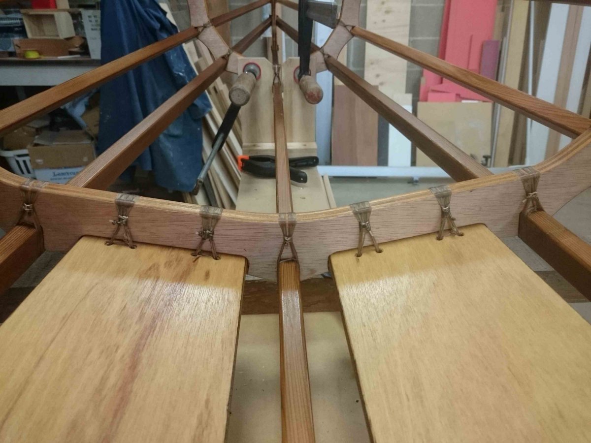

  6. Thanks Dave, Good advice re epoxy. My stonefly is nearly finished now. I have successfully skun it and have given it 3 coats of finish with 1 to go. The fabric went on really well with no dramas. Got myself some amusingly home made looking canvas pliers from chine an ebay which despite the crude construction of said tool did the job and allowed me to pull it up nice and tight. I had a few minor wrinkles along the gunwales which the iron managed to remove though I missed a couple on the underside where the fabric had been folded for postage. Maybe next time I will iron those out before I start. Got some stainless steel staples (8mm) which seemed just the right length. Made up some rubbing strips out of cherry I had in the workshop almost as much work in those as the rest of the build. Question - looking at making a greenland paddle. Will this type of paddle work for a stonefly? Anyway here are some more photos even though this forum seems to be almost deserted! Looking forward to getting it on the water, maybe next weekend. (sorry about the upside down photos I don't know what is going on there) cheers Tony

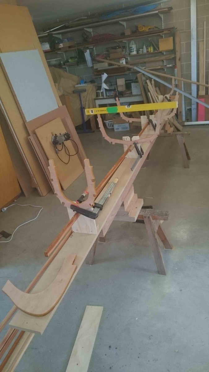

  11. Starting to get very exciting as we added the top stringers and held them in place with the ocky straps. Next we clamped the bow and stern in place and quickly trimmed of any excess length before starting to trim the stringers to the stern. With my japanese saw and block plane we had them nicely fitted in no time. It was then we got out our new roll of sinew, drilled some holes and paying careful attention to the book made our first lashing. Pretty good though they all shifted down a few mm's on tighten them up. At the bow I had a hole above and below the stringer through the frame. That stopped them sliding anywhere. After that we started lashing the stringers and after our first frame and then resting our fingers we did a better job on the next frame. I did end up wearing some gardening gloves as I was getting some tender spots on the fingers. I reckon it took about 8 hours to complete the lashing and I must say that I am very impressed with this method of joining timber together. So much more elegant than screws and glue and I expect far stronger with the added bonus of having a bit of give. Really starting to look like a canoe now, and very elegant it is too.

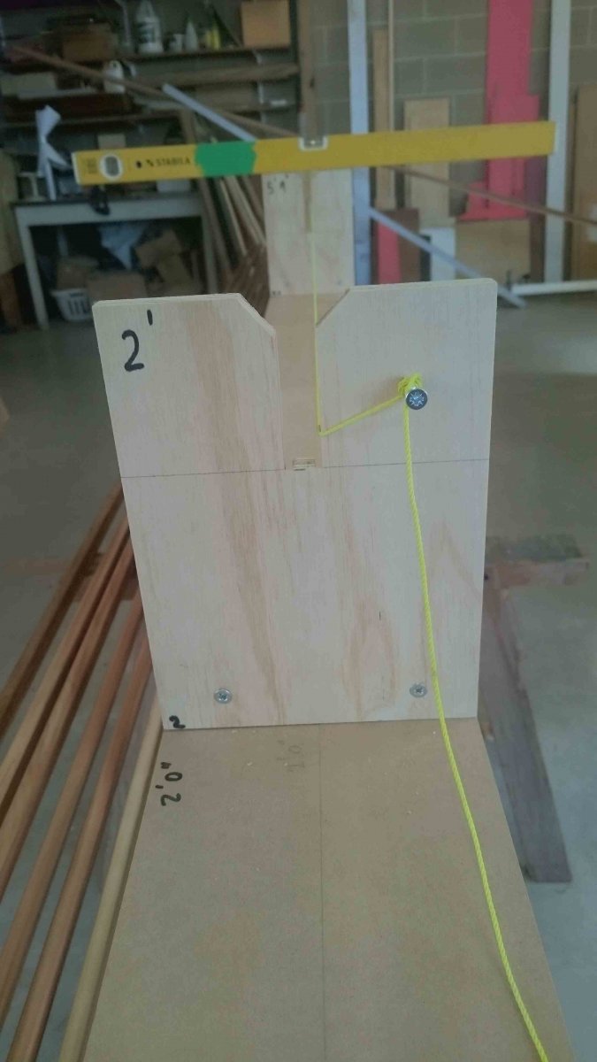

  12. The strongback. I bought 2 x 3.6m lengths of 90mm x 45mm framing timber for my strong back and screwed it to a few other bits of 90 x 45 to extend the length, carefully leveled and straightened it then added a few strips of MDF to give me a nice flat surface to build on . This was then screwed to some blocks on my little saw horses so it was at a good height. Before I did anything else I gave all the long lengths a sand as they were too long for my workbench. I then carefully marked out the frame positions made up some brackets and screwed them in place. Now I feels like something is happening. After checking each frame for squareness, levelness plumbness and position Henry and I then layed the keel into the slots in the frame and clamped on 4 of the frames. I then decided to make 3 more frames to hold the other 3 frames in position.

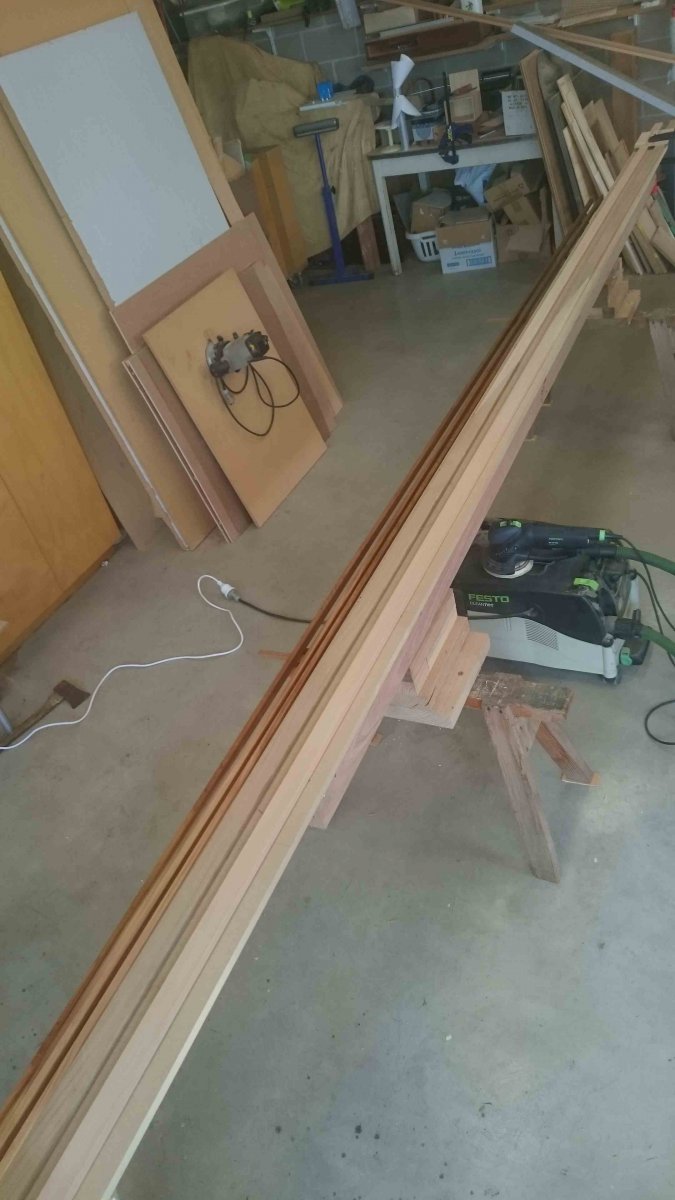

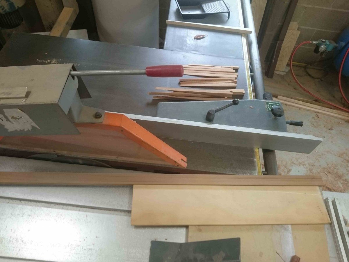

  13. I next sourced and bought some western red cedar for the stringers. I bought 10mm x 50mm 2 x 2.4m lengths and 2 x 3.0m lengths. I then ripped it up on my table saw to the exact dimension of the stringers and gunwales and scarfed them together using my trusty epoxy glue. The scarf joints are about 300mm long. Next I ran it all through my router table with a 2mm radius round over bit. So far so good. I used masking tape to clamp it together whilst the glue sets. Brilliant stuff.
