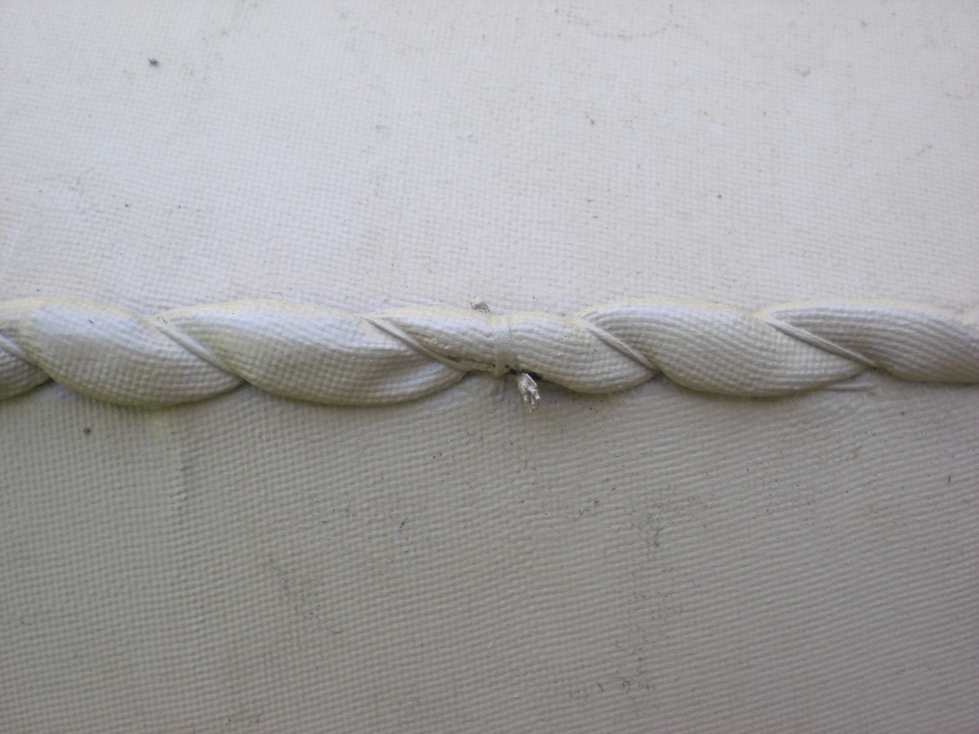

My approach to sewing was to work with relatively short lengths of cord (Dacron fishing line) until my fingers got tired, I got bored, I ran out of cord, or my wife called me to do something. At that point, I'd tie off. Next time, I'd start a new run. Rationale was that it was easier to work with shorter lengths and if the cord broke somewhere (admittedly a low probability event), only a short section would fail. Turns out that lengths between knots range between 1 and 2 feet. A picture of one knot is attached.
Fair winds, Andy
Thanks Andy, that sounds like a good approach. I like it and will adopt it if I stitch. I'm still contemplating the heat'n'bond tape method though. I know it works well for open canoe type boats I don't see why it wouldnt work for a kayak.
