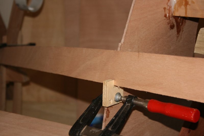

  8. I am being extra careful on my shapes and the gains moving onto the next lot of strakes. I have also been doing some 'spiling' practice. I have now got two battens made of of cut offs from ply that has already been scarfed. Each batten is about 2 1/2 - 3 inches wide. Here are some shot if me practicing getting dimensions at the bulkheads for strake 7. First shot show spiling batten laid across forward bulkhead and stem.

  13. Nearly that easy. I worked out the maximum width and cut two boards that width and scarfed them so there was a straight edge to sit along the keel line. I then measure along the keel line the distance from the transom to each bulk head and marked that point on the stock and draw a 90 degree line at that point across the board. Then went back to the boat and measure the distance from the keel line to the 'notch' for each bulkhead, transom - marked these on the stock, put a small nail in each point and used a long batten to lay a curve. Then cut both bits out leaving a bit extra at the stem end because I was not sure how to get the shape there.
  14. Hi John Graham put that in on one side to try it out and worked out he did not need it - the stem, forward bulkhead, mid bulkhead, rear bulkhead and transom give the 'contact points' necessary to give the right panel shape.

  17. Took a leap of faith today (with some tuition from Graham and some reading) and cut my first strakes today. Started with the Garboard which is fairly straight forward as it has a straight line along the keel. The only bit I am unsure of is how to finish it off at the bow. Graham had the measurement for strake 2 - so I am going to cut those, tack them in place and use them to work out how to finish off the bow end of the garboards. Any hints or pictures Tom of where you garboards finished at the bow. From your experience do you thing the strategy I am planing to use should work. I have been playing around with a spiling board to take measurement off the boat. Think I have the basic idea. The is a picture below with the marks you make with a compass - you then put the spiling board on your flat stock and put the point of you compass on one of the arcs on your spiling board and draw and arc on your stock. You then put the compass point on a different part of the arc on your spiling board and make another arc on your stock. Where the two arcs cross on your stock corresponds to the point on the boat you were locating.
