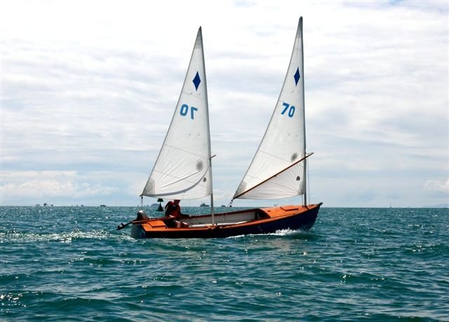

Yes Geoff = I had changed over to a mast track to make reefing easier. You can not tied webbing around the mast because it then goes over the track and won't allow the sail to come down (part of what got me in trouble having rigged up webbing to stand in for the saddles that had poped off. -
I will post some photos later - and talk more about the 'calm' part later. On my way over I poped the rivets I had just put into a saddle on the mast holding the snotter. (have just changed over to mast tracks rather than sleeves). I have one reef in with I left but shook it out when the wind dropped abit. Nice reach down the harbour. But on gust a bit strong - ping goes the mizzen. Re grouped and tied some webing around the mast with a D ring and rerigged the mizzen mid harbour. Later that afternoon 'racing' some of the other boats in very gusty conditions - that same thing happened on the main mast- ping. I was near the beach so headed in , used webbing and a D ring again. Headed out for some more fun sailing around Islington Bay. Calm overnight and about 10 15 knots on the nose when we left. Beating home in a Westerly a massive squall came through ( I can't estimate but it was really strong). Paul in his Pathfinder furled his jib, dropped his main and hove to under mizzen. I dropped the main as far as I could, but the webbing around the mast stopped me getting it down far at all - way to choppy and winding to get out on the fore deck. In the confusion didn't think about dropping the sail abit would loosen the snotter. It come out of the d ring in a gust and the sprit (still attached to the boat went over the side. I got stuck under the boat around the rudder. At this stage things were looking ugly with a volcanic lee shore coming up quick. Tried to start the outboard - It kept starting and then cutting out. When I looked over the side the snotter rope was wrapped around the prop. Got the sprit back aboard, bit couldn't get the rope free. Finally unwrapped the rope from the prop and briefy started the motor and pulled 6 feet further way from the lee shore - the another bit of the rope caught around the prop.!! Cleared it again and finally got underway into a strong headwind and steep sea (my 2hp only just did the job.) Lesson One. I should probably tried to get up on the fore deck and got the anchor out of the hatch and anchor to avoid the near miss with the lee shore - I don't know how I would have gone if I had thought of it. Tidied thing up. Got the webbing off the main mast and dropped the main and stowed it up forward. I sheeted in the mizzen as I was going straight into the wind (another mistake). I was under power and a keel boat close hauled was going at me and I could see I couldn't clearly pass in front of her - so beared off to pass behind her - not thinking of the mizzen sheet in hard. Another strong gust hit at that point and ripped the mizzen mast through the seat that supports it amidship. It also split the fiberglass top of the mast. Derigged the mizzen - got everything onboard and strapped in and started a long slow trip back using the 2hp Honda into a strong head sea and wind. Themnran out of petrol(gas) the the wind pivoted the boat and started to blow me back where I had come from. Re-filled and limped home. The boat is cleaned up and back in the garage. A good (if slightly too exiciting) experience. I learned a number of valuable lessons and picked up some bits I need to beef up. All of that being said - the day before was great - and today a valuable test in extreme conditions. Paul and Dave's boat with their heavy centre board stood up better then my much lighter boat. Anyway - thought I would share the adventure. :oops:

I thought with some experience building up it might be useful to ask for some tips and tricks from those of you that have been playing around with how to get the best out of these boats with the cat ketch rig. For example Graham pointed out from some photos that I am sitting to far aft going to windward. Although I am 'just cruising' there are some others that I sail with who test our boats against each other. Any useful tips to help me defend the honor of the Core Sound boats would be appreciated. eg. maximum degree of sheeting in going up wind (angle of sail relative to centre line. How 'full' or 'flat' to keep the sail. (I have been keeping the tension on the snotter pretty tight - therefore pretty flat) etc.
