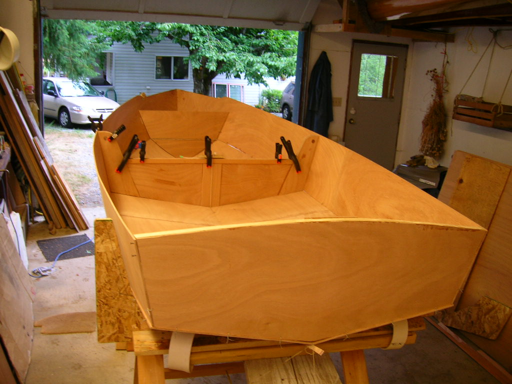

  6. Hi Larry, Your Spindrift is looking great. Congratulations! It's an inspiration. I'm at the centreboard-trunk-installation stage on my Spindrift 10N. The project is slowwww going, but I have a couple of questions: Does your centreboard trunk feel secure with the only lateral support at the nesting bulkhead? It looks like you have no inspection ports in your rear seats/buoyancy tanks. Did you do anything special to the insides of the tanks? Thanks for sharing your photos, Cheers Bruce

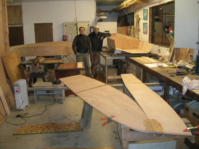

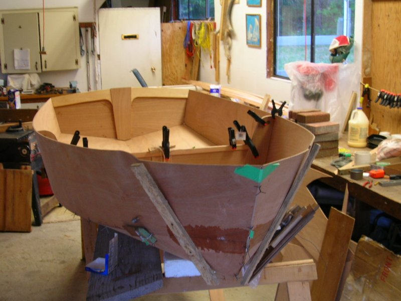

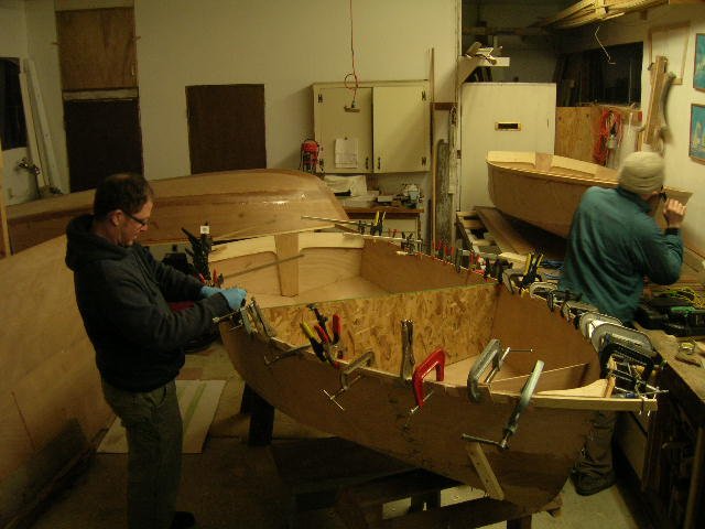

  7. More clamps! More clamps! I need more clamps! The guys didn't like the PVC clamps I had made so they raided every clamp they could find in the shop and brought along a few of their own. They even found a couple of vice grips that worked well. #4 and #5 of the Spindrift quints are soon to be at the butterfly stage. Then things will get crowded!
  8. We are getting some progress, having committed one evening per wintery week to working on the boats. It's amazing how you forget about your fingers after they have been cold for a while. Here is a photo of #3 of the Spindrift quints. Numbers 1 and 2 are in the backgrount. This is at the start of the evening

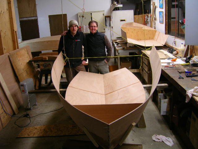

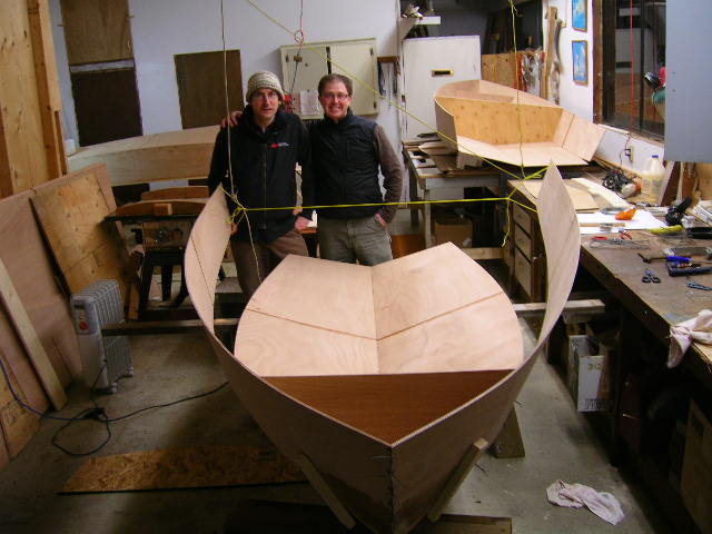

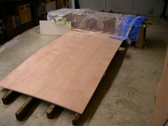

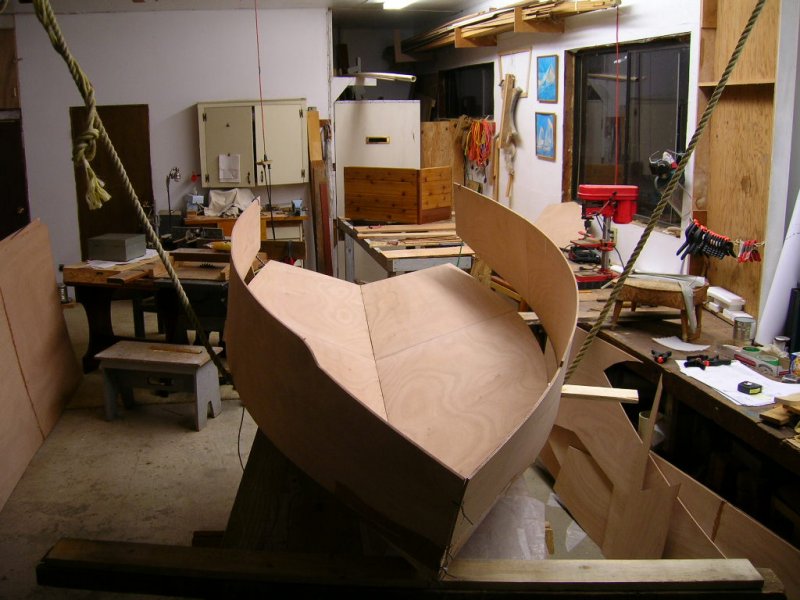

  10. And with everything going so well I forgot about the camera and soon a bunch of plywood pieces began to look like a hull! The transom was already glued up, so on it went. The wiring goes so quickly it's really quite an amazing concept.

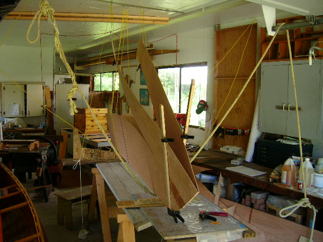

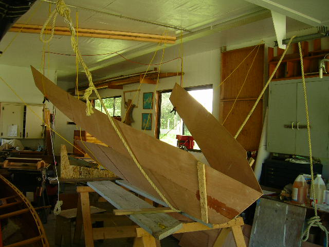

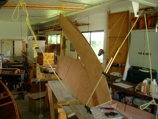

  11. The summer was a write-off in the boat-building department, but I did get some keel-boat sailing done and lots of stuff fixed up around the house. Now it's time to get going in the shop before the weather gets too cold. After my butterfly joint broke, I took the grinder to the fibreglass and carefully ground it down to the plywood. It was easier than I thought. I re-fibreglassed the butterfly and screwed a stick across the joint to keep it from bending. I was concerned about loose wings of plywood stressing the butterfly joints so I hooked up an old curtain rod on the ceiling and hung the plywood wings with ropes so they always had some support. Here's the opening sequence:

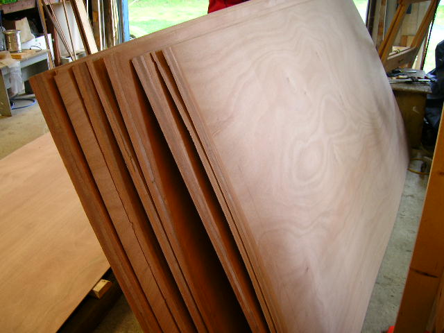

  12. Hi Bryan, I am building (when I get back to it) a Spindrift 10N on Vancouver Island and had some 5 mil okoume ply shipped from Noahs Boat Building. The 5 mil is 6 lbs per sheet lighter than the 6 mil and is still five-ply. Stitch and glue kayaks are often built with 4 mil ply but it is only 3 ply and I think would lack stiffness and strength. I too intend on using fibreglas cloth (probably 6 oz) on the bottom and maybe the whole hull to increase toughness. Graham has endorsed the thinner ply with the suggestion of maybe adding bottom stiffeners on the rear section of the boat if it is felt to be necessary. My boat is currently wired together and collecting too much dust. I am itching to get back to it soon. Bruce

  14. After too many weeks absent, the first Spindrift finally took shape last night. The butterfly joints were done weeks ago and felt strong. Opening up the butterfly to make it look like a boat came together really easily with no creaks or groans. The ropes I hung from the ceiling helped support things during the unfolding. Unfortunately it looks like the stress was too much for the 10 ounce fibreglass tape as the cloth fibres on the outside of one of the butterfly joints have torn. The inside of the failed joint doesn

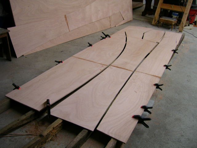

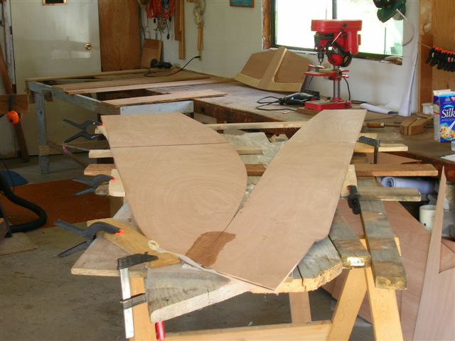

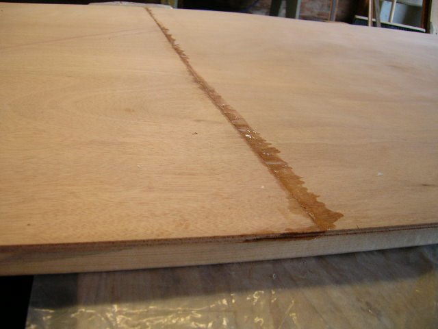

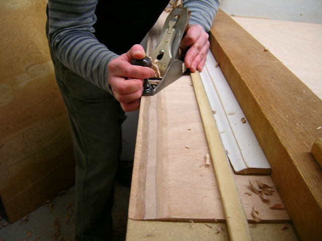

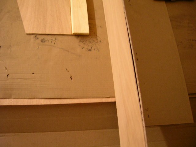

  15. Hi Randy, If you are doing a scarf joint 8:1 is a recommended minimum. We are building five Spindrift 10s and have most of the scarfs done and they worked out well. When gluing (with epoxy resin) we layed down a flat piece of 2 x 10, put some poly on it so the epoxy wouldn't stick to the 2 x 10, applied glue to both scarf edges, aligned them on the poly then tacked them down at each end with a one-inch finishing nail. We did a couple of joints at the same time by stacking them one on top of the other then piled up a couple of rows of bricks on a board to weight the whole thing down. I like the scarf joint as it is smooth and barely needs fairing. Bruce

  17. Yes, I am using 5 mil okoume plywood. I was looking for a bit of weight saving as I am planning to use 6 oz fibreglass cloth on the bottom outside and propapbly inside as well, and maybe 4 oz on the sides outside. The 5 mil okoume is 5 ply and weight 16 lbs per 4x8 sheet. By comparison, the 6 mil okoume weighs 20 lbs per 4x8 sheet. I ruled out 4 mil as it is only 3 ply though many kayaks are built with 4 mil. I emailed Graham before I discovered this forum and he felt my idea of the fibreglass sandwich construction was sound, but would not be stiffer than 6 mil plywood. He also said the boat was stiffer than needed with the exception of maybe the aft bottom. I was looking for a bit of toughness as we have lots of rocky shores and barnacle beaches along our coastline. I also am really impressed with the durability of my cedar strip canoe and kayak, both which are entirely encased in fibreglass inside and out, and still quite light. (The 16 ft canoe is 50 lbs, the 16.5 ft kayak 40 lbs) I

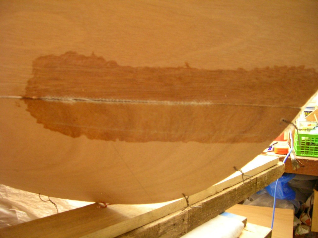

  22. So here's a few photos of our scarfing. Gotta do a bit of mass production! Bruce With fresh snow outside we had to add a bit of heat. (Though I am using Cold Cure Epoxy)
