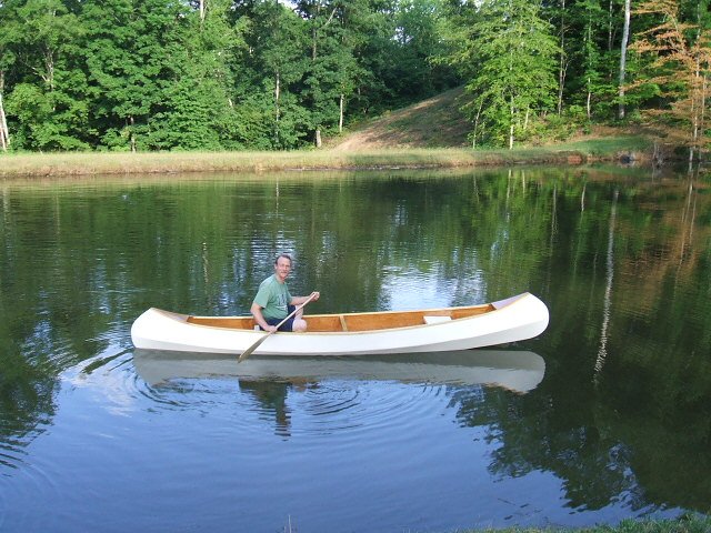

  6. Of course, you know I just had to get her wet. Took a quick spin down to a friend's pond and put her in. She's tippy just as I thought but then again, she is designed for a two-man crew.

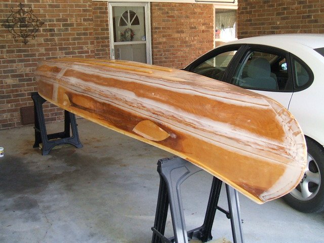

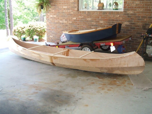

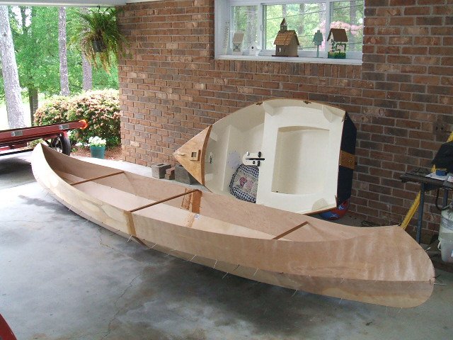

  11. a little sanding a cleaning and I should be able to start painting tomorrow.
  12. That's the sharpest deck on any weekender I've seen and looks like Half-fast will be a beaut too!!

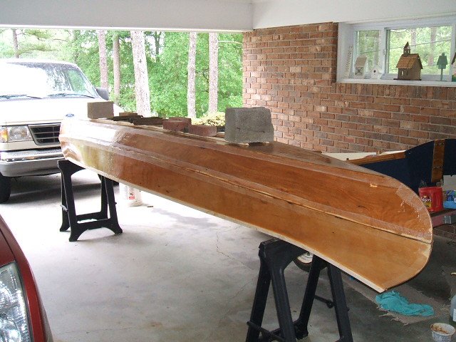

  14. I have installed the seats and breasthooks. Now it is just a matter of sanding, fairing, and painting and I'm in the water!

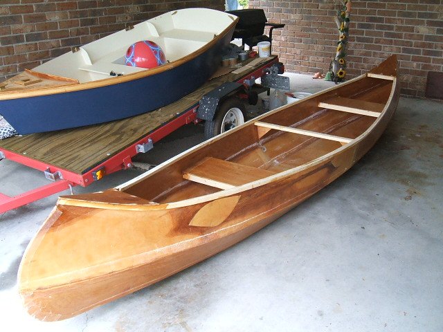

  17. Canoe is all taped up and plywood epoxied. Just need to do seats, a little finish work, fairing and she's ready to paint. I'm going bright on the inside and a light cream on the outside.

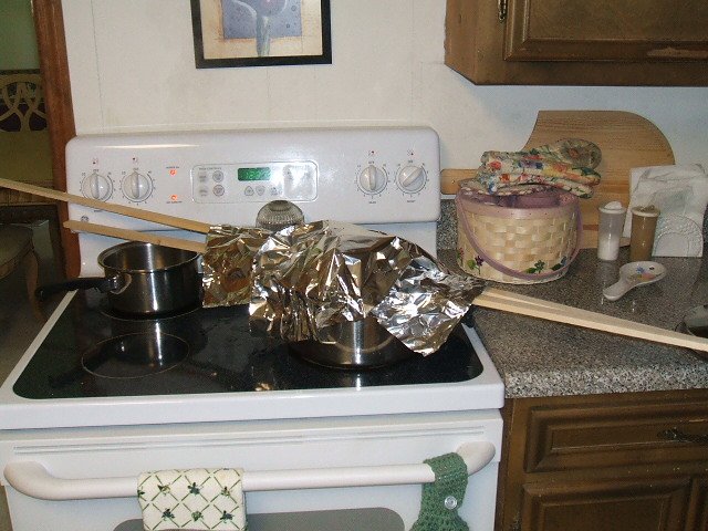

  18. steam setup:
  19. the gunwales had a pretty good bend near the ends so I steamed them over the stove. Here is my setup:
