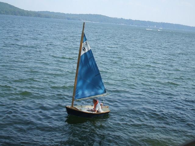

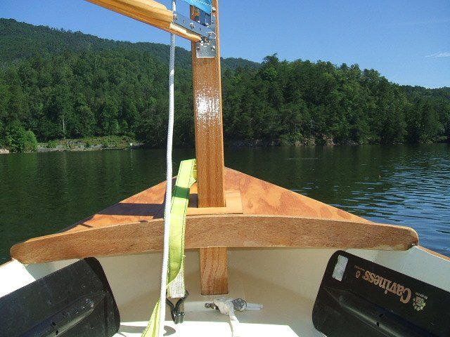

  13. BTW - here are a couple pics of the dinghy: one showing a closeup of the mast setup

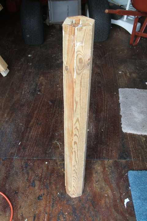

  14. Back to the birdsmouth spar. I'm thinking about making one for my dinghy. I need a mast that is 12'6" high (from the step) that can carry a sail of 45 sq.ft. The mast is unstayed. Lowes carries 1"x4"x14' clear pine that I'm planning on using (I know I should get sitka spruce - but, sheesh, this is just a 7&1/2' dinghy made from luan). I can make a 6-sided spar by splitting the stock in half and come up with a spar that is about 2&7/8" in diameter; or I can make an 8-sided spar up to about 3&1/2" (or even a little larger if needed). I would taper the spar down to about 2" at the top. I would make the bottom 1&1/2' of the spar solid which would make it solid 3/4' above the deck. Is the 6-sided sufficient? It would take less material, less labor, and no waste. Or should I go with the 8-sided? I have never seen any specs on this. Just kinda thinking common sense at the moment. Thanks for any input.

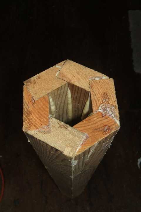

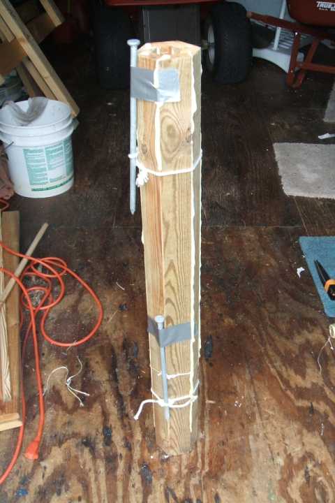

  15. I think it was the heat that he was concerned about. The guy lives in S. Africa. He apparently has done some significant work having built an 18 meter mast before. Anyway, the rain stopped and I finished. Used gorilla glue (though I will use epoxy if I build the real thing). I had 4 pieces of scraps but one was warped so I made a 6 sided trial. Used 30 and 60 degree cuts. didn't have to reset blade, just turned over the staves. Joints seem pretty tight. Now I'm ready to build a real one!
  16. I found the site: http://www.duckworksmagazine.com/06/howto/birdsmouth/index.htm Go down about 2/3 the way down. "This is the mast stave scarphs being glued. The glue is a special Phenolic Resin. Note! NEVER GLUE UP MASTS WITH EPOXY!"
  17. Just got rained out of a trial effort to build a birdsmouth spar (3' long). Seems I just read on a site the other day (can't find it now) that you should NEVER glue a birdsmouth spar with epoxy. That was a new thought to me. What do yo use to glue up a spar? thickened epoxy? gorilla glue? elmers wood glue? or what?
