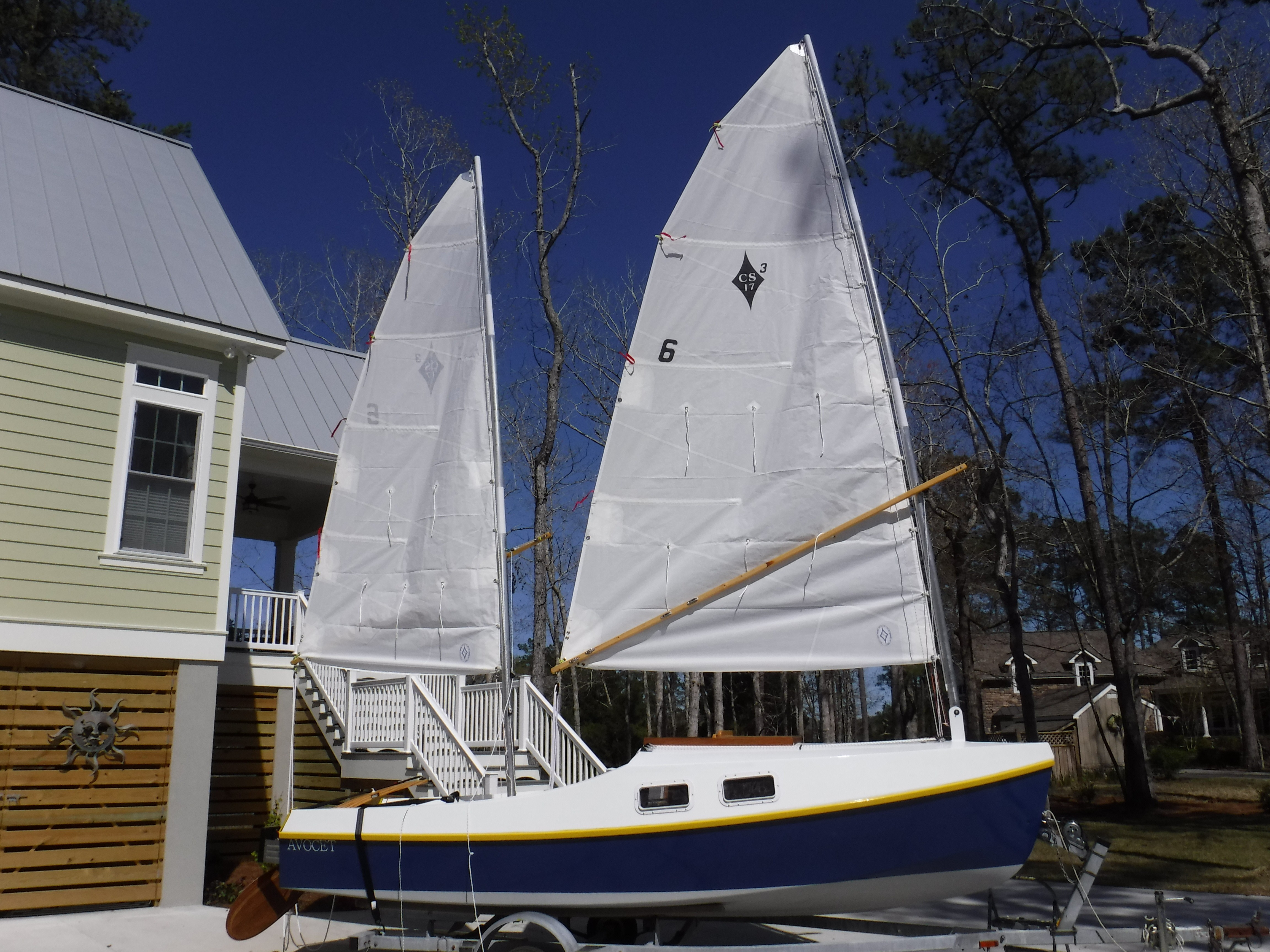

  17. It has taken a long time but the hull(#6) and spars are complete. We took the boat for a test motor this last weekend, filled the water ballast and emptied it. Only a small drip from bottom gudgeon which was an easy fix. If all goes well, we will sail this weekend. It has been two years, three houses, two job changes, three sanders, acres of sand paper, and cases of rubber gloves. ( and we need more rubber gloves now) Most important, without my wife's hard work, patience, opinions, and sound advice, this boat would not be complete. She has been a willing co-conspirator. Richard Johnson
