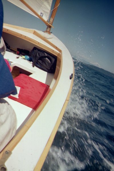

Good points. I had forgotten why I own the coresound myself. When compareded to your aluminium boat, you will think your in a luxury yacht. I sail in the northwest US and western canada, so we have alot of steep tall chop from wind and strong tides. On my last overnight trip (see post on Sucia Matia Islands) we encountered gusts to 30 and 4-6 foot "wind waves". When our destination was on a reach we just dropped the main and sailed on the mizzen in the trough. Wind pressure on the sail keeps the roll to a comfortable level, and since we weren't having to go over the seas we were moving at hull speed or better. The times we encounter these conditions and the destination is upwind, we change our destination :-) I have said it before, this boat handles weather I would never expect a 17 foot skiff to cope with, and I have made my living on ships so I have something to compare it to. All the kicker boats and fishing skiffs in the same size range are long gone before the coresound starts to get uncomfortable. -

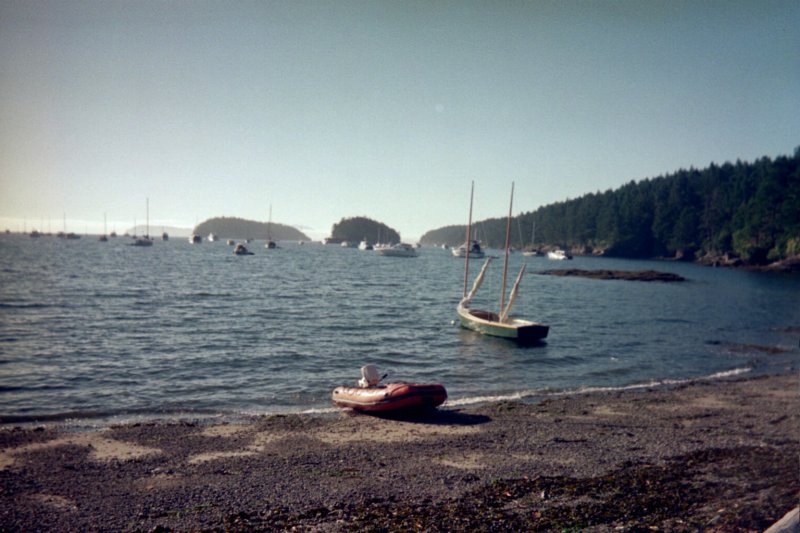

Yes, we rode the tides. We don't carry an outboard, and rowing against the tide in Rosario is not an option :-) We left Bellingham Friday at 1800 and were anchored at Sucia about 0115 Saturday. On the way home we left Matia at 1000 on Sunday and arrived in Bellingham at 2130. An outboard would cut a lot of time off in the uncooperative conditions, and I may reinforce my transome for one soon. But it is rewarding to make the trip without one. I had hoped to make it up next weekend but I don't think my schedule will work out. I am going to miss seeing your boat. Have fun!

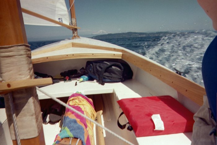

We just came back from Sucia island with some wild conditions. Winds would be dead calm and then come up to 20 - 25 knots in ten minutes. Crossing Rosario Strait and Bellingham bay we had higher gusts and steep chop 4-5 feet. We found the best solution was simply to drop the main, slide the centerboard about half way up to move the center of lateral resistance aft a little, and go on the mizzen alone. The boat carries 10-15 degrees of weather helm, but we were only heeling about 10-15 degrees. Not pretty but very easy and effective to make a run for cover. My masts are solid spruce and about 1' shorter than the plans to keep the effort lower, I also carry about 12% more sail area than the plan. After a couple of days of this on/off wind we quit running for cover in the blows, everything the boat does is so predictable. I don't recommend seeking extreme conditions, but the coresound is capable of handling ALOT more weather than I would ever expect from a 17' skiff. p.s. hope to have pics from the trip soon
