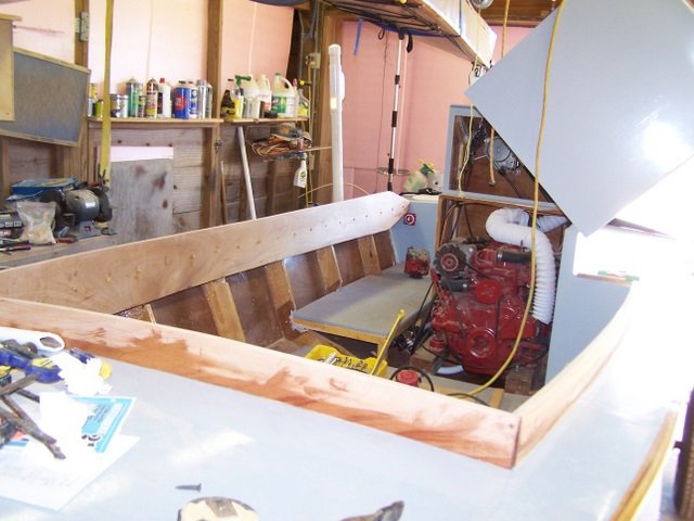

I was able to get a full day on the boat today and was able to get the coaming "glued and screwed" onto the boat. The plugs over the screws are also glued in place. Sanding is coming later this week.
Hey Guys, We finally broke down and put the boat back in the shop on the trailer to work on it in the Air Conditioning. It was just too ____ hot to work outside. Wally took the rudder off and we are adding some blade to it to improve the authority. We also put a check valve into the raw water circuit and are adding oil pressure and temp senders for the instrumentation. There was also a minor (no pun intended) problem with the wiring and we were able to trace it and correct the situation. Meanwhile, I have found some mahogany and am making the coaming around the well deck/cockpit. It will be finished bright and should make the boat look better. Here are a few shots of the dry-fit coaming on the forward and port sides. Starboard side is next.
