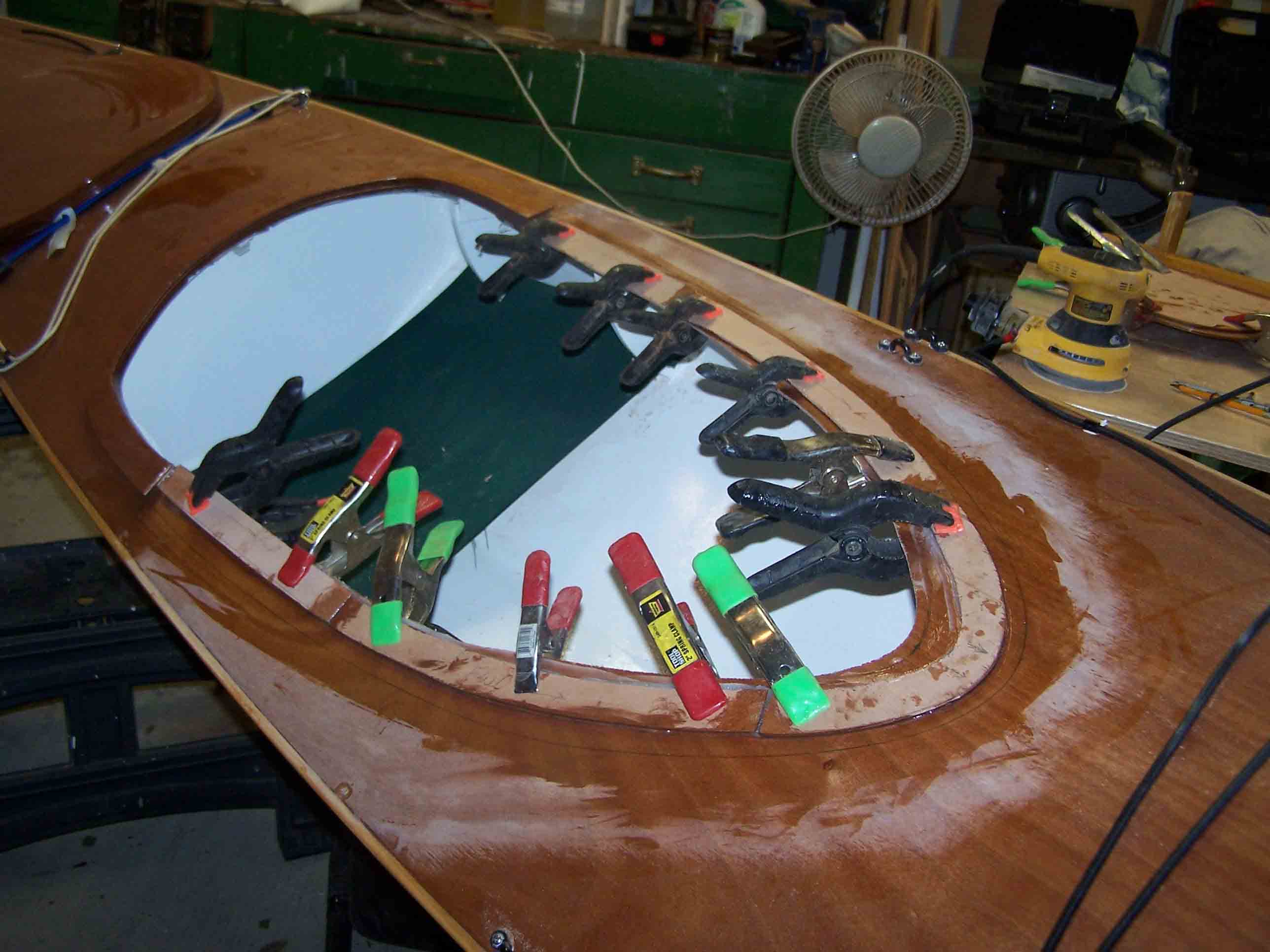

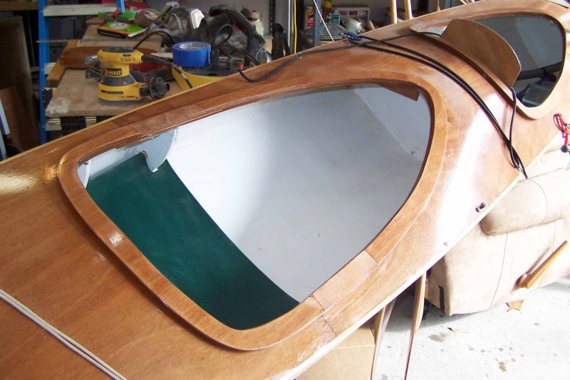

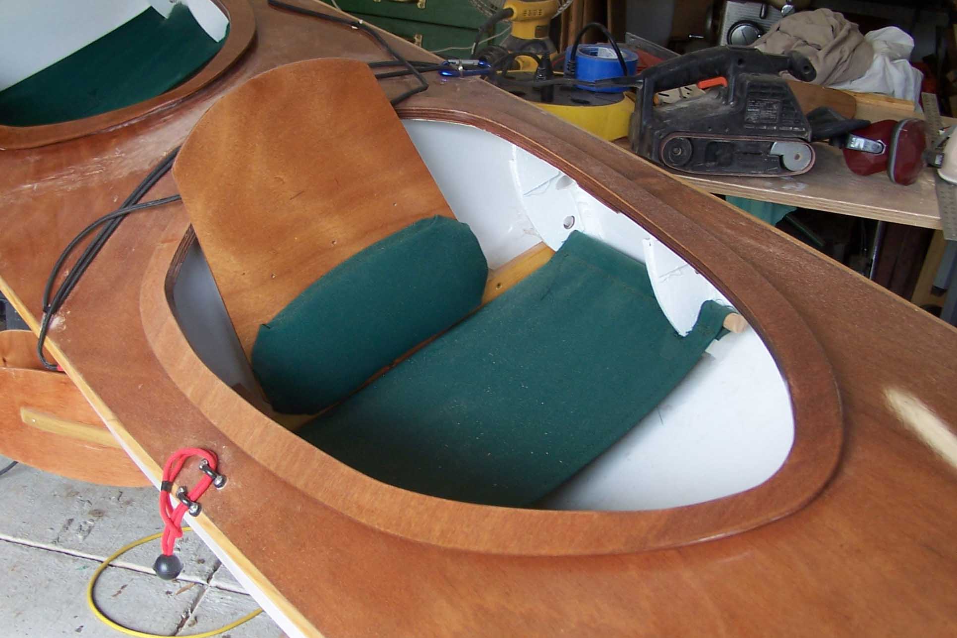

I was thinking about my Diva 2 kayak and realized that there were a few modifications I needed to make to ensure that Gina and I are more comfortable when we go on long paddles. The first of the year seemed like a good time to do those mods, since the paddling season gets started in the next few weeks here in Alabama (if it ever stops). The cockpits in the Diva are fine as long as you are not as tall as I am. I am 6'3" and I found I could not get my feet and legs into the cockpit comfortably. I studied the situation and decided that I would lengthen the hole by moving the coaming forward about 7 inches and adding a section to the coaming at the widest part. It was an interesting exercise as I cut the coaming off and added the spliced sections. Here are a couple of shots of the project after I cut off the coaming and was epoxying the first layers of the new coaming onto the deck section. As you can see, I rough cut the new hole and will trim it after I get the whole coaming epoxied in place. The next photo shows the coaming after it was completely installed and faired, with a coat of epoxy applied and curing. The other project was to improve the seat back for my wife's seat. She has some concerns with lumbar support, so I built a back rest for her. We have tried it once, but the support was too high. I have lowered it a bit and we will try it again. In the meantime, I built a similar back support for me and will try it on the next trip. With the expanded cockpit, I should have enough room to use such a support. I am finishing up the repairs and will have the boat ready for "sea" in a couple of days. We are hoping to participate in a paddle next weekend, if it is warm enough for my bride. Contrary to popular opinion, I am alive and working on a project or two. Steve
