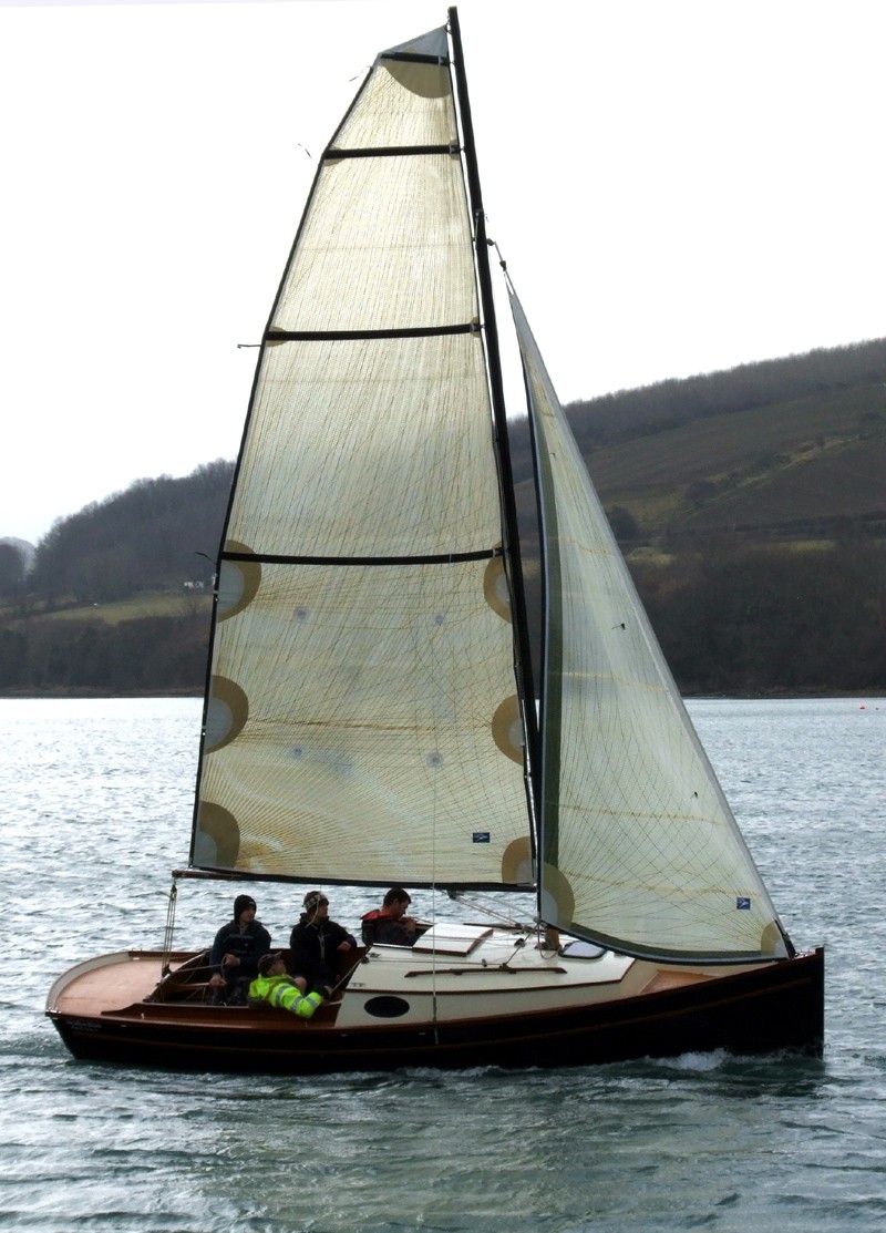

I see what you mean. I was thinking something like this (see attached photo). If I added some light stays to port and starboard like the picture attached it might work huh?

The boat is nicely balanced with the main in the center hole. Adding a jib forward of it could give you a hellacious lee helm. (bad!)
Go ahead and sail it with just the main. With a nice breeze it's a real joy. Instead of listing she just accelerates. Way too much fun! You just steer and the sail pretty much takes care of itself.
Maybe it would be a good idea to borrow a sloop and remind yourself how much fun it is to have shrouds and stays to set up and jib sheets to tend.

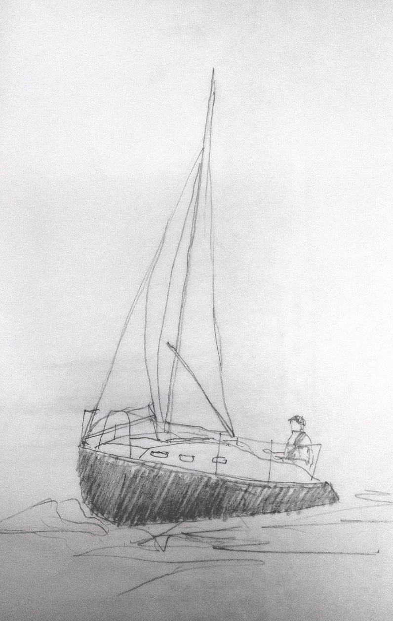

Oh, I forgot that I promised a sketch of what I am planning or what First Attempt would look like with just the main....I did add the non overlapping self tending jib...sorry about that Gordy. I will drop that off. Oh and I also forgot to say that part of what is driving this is the fact that I have a cuddy--which I love here in Alaska.
Excuse the drawing, after all I am only an architect....

Yep, the two issues I see (as others mentioned) are: (1) you'd need to add stays to prevent the flexy mast from distorting the jib shape, which would then complicate some of the rig's simplicity of operation, and (2) the third mast step position was designed for optimal balance with a single sail already, so the jib would likely throw that balance off again.
Not to push you back to the ketch plan too vigorously, but I really do think there must be a solution to your original issue with reefing the main that would make that process feel more manageable to you so you could keep the original ketch plan, instead of switching the rig to a single sail and jib as you're proposing. I'm totally sold on the ketch plan, even though it took me awhile to fully understand how to reef the main successfully in moderate to heavy winds. I keep thinking some kind of jiffy reefing setup would be a better solution for you, but then again, I don't know your sailing conditions firsthand, so take my input with a grain of salt in that regard.
I think you are ultimately right Wes. I am going to try using the main in the center step without the jib. I have looked at the center of effort with the jib and without. Where Graham placed the center step is about 10" lead of the center of lateral resistance which is just perfect. I may increase the size of the main which according to my scribbles could be 120 sf. as long as I line up the new main with the centers of lateral resistance where Graham designed it. It should be very balanced. So I think you are right--problem solved without shrouds, stays or a jib.

Another thing to consider is that adding shrouds to a mast will add A LOT of compression stress to the mast and step. Without beefing things up considerably I don't think you would be able to get anywhere near enough shroud tension to accomplish what you want, and you would be dramatically increasing the likelihood of a mast failure.
