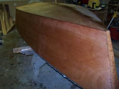

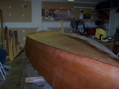

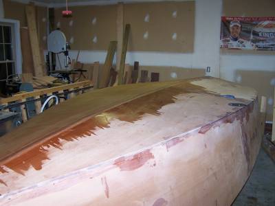

Phil Stallings Posted July 4, 2010 Author Posted July 4, 2010 Thanks for the info. This is my first build and I didn't know Graham had a Bay River Runner and that is probably the boat I should have built. At first I was going to add the centerboard and mast's but I decided against it because I will be moving from New Bern in 5 years to the foot hills of NC to retire on the family farm. The 10 acre lake on the farm wouldn't be much fun sailing. I am not to concerned about speed except to get off the water in case a storm comes up. I will mainly be using the boat to go back up in the creeks of Eastern NC to fish. I am interested in the temporary wedges that you mentioned. Will this help in getting the hull to plain and get more speed? Can you please give me some more info on what the look like and where to place them? I glassed half of the hull on Friday and hope to do the other half tomorrow. Progress is slow because I have to work in order to be able to play with the wood. I am trying to get it done by September so I can use it before the weather gets to cold. Thanks Phil Quote
