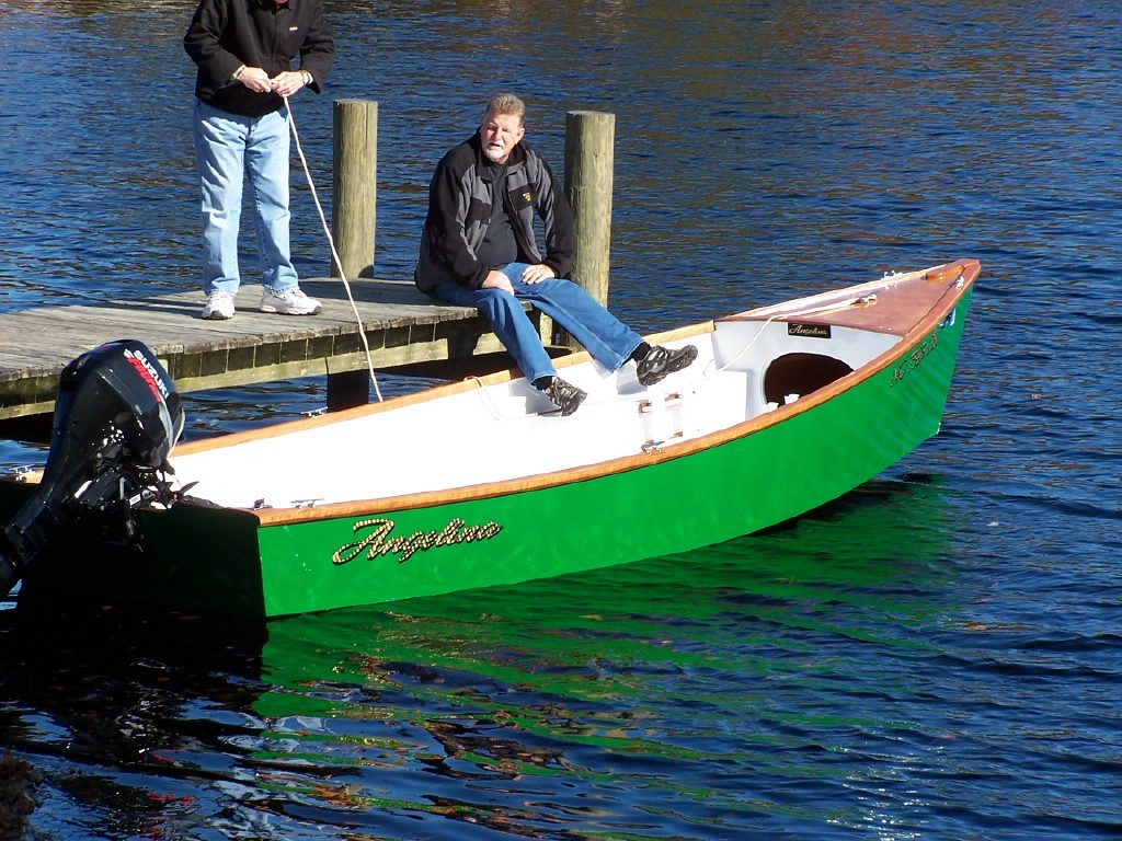

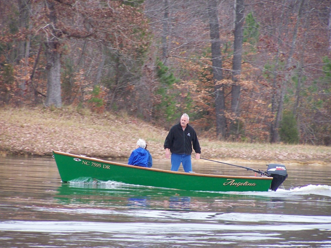

  7. I have been breaking my motor in and the best hull speed I got was 16mph with a hand held GPS. The motor I have is a Suzuki 15hp 4 stroke long shaft. I took it to Graham Byrnes Saturday and told him that with the motor tucked in water would come in over the transom, when I kicked it out it was a little better but the bow was way up in the air. Graham decided that we should raise the motor on the transom about 1.25". This made made a tremendous improvement. I can now tuck the motor in and the water stays out of the boat and I am now running 17.3 knots per the chart plotter that I installed. Needless to say I am very pleased with the performance. When I got back to the house Saturday I started making the modifications. I will have to include the pictures in two post because of the size.

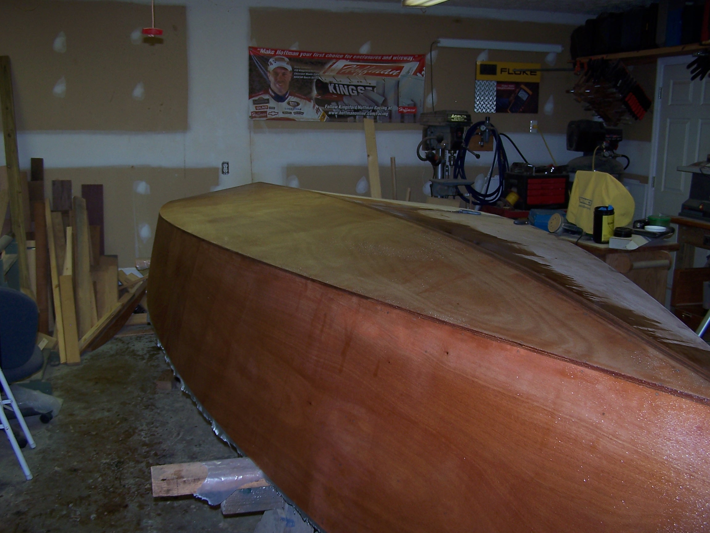

  11. I just just launched my BRS17 in November. This was my first boat build and I used 10 oz cloth on the outside for peace of mind. I will be using my boat for fishing and I guess it made me feel better that I had a little more protection on the bottom. I also added a stainless rubrail on the keel.
