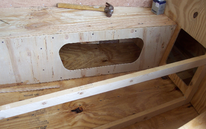

Well her winter home was not "Home Sweet Home". She was at my parents house, out of sight out of mind. During the course of the winter she got about 50 gallons of water in her. And a lot of mold. I had to remove the cabin and cockpit seats. The hull is sound so all is not lost. Today is the first day of construction. I cut the parts for the rudder box, got them coated with epoxy. Tomorrow I will assemble it all.
  • 1 month later...
Well as I said before I had allot of scrubbing to do :angry: That is done :) I have started on the seats again, this time it is going a little faster. Thank goodness it is not as hot as it was last year B) I now get a little working time with the epoxy.
While you're there, you may want to consider installing a cockpit drain. Mine is made from a couple of pieces of galvanized pipe run through the keel and glued into place. For a drain plug I use the cork from an empty rum bottle when sailing.
With the drain at the transom I can still get a few inches of water in the cockpit as it pools at the front of the cockpit when the boat's on the trailer. Putting the drain at the front of the cockpit might be a better option. I also get some water that will sit on the seats.
Last winter I invested in a good heavy-duty tarp and had hardly any water in the spring.
